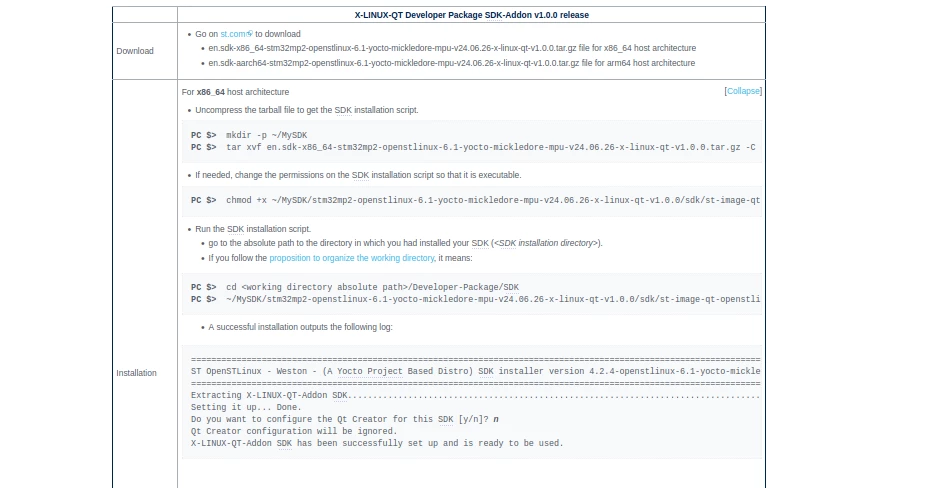

I went with developer package as i was not able to do the distribution package
so the steps i followed for developer package was
i downloaded the MP1-DEV-x86 from st website
For x86_64 host architecture i Uncompressed the tarball file to get the SDK installation script. and Ran the SDK installation script.
for x-linux-qt developer package i downloded the below file(but my board is stm32mp157d-dk1)
i followed these steps

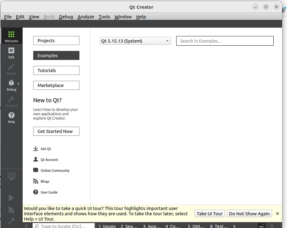

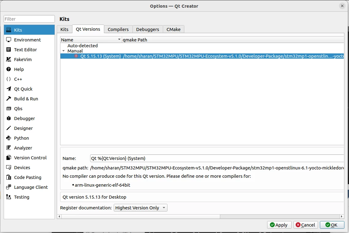

in the terminal i download qt creator using sudo apt install qtcreator and it installed  (qt 5.15.13) and u had said Qt Creator will be configured automatically and you will get your MPU kit all set in Qt creator. but i cant find anything other than Qt 5.15.13(system)

Oct 14, 2024 7:31 AM UTC
The full MP1 X-LINUX-Qt support will be available in the coming weeks.
Distribution Package allows anyway user to compile with Qt libraries and run Qt application on MP1.
But for Qt creator MP1 kit configuration, you have to do it manually.  Please refer to that post:
https://community.st.com/t5/stm32-mpus-embedded-software-and/qt-creater-setup-for-stm32mp1/m-p/706440
For MP2, the SDK-add on configures Qt creator kit automatically, but for MP1, the SDK-Addon is not yet delivered. Sorry of the inconvinience. It will be release soon.
Philippe.
