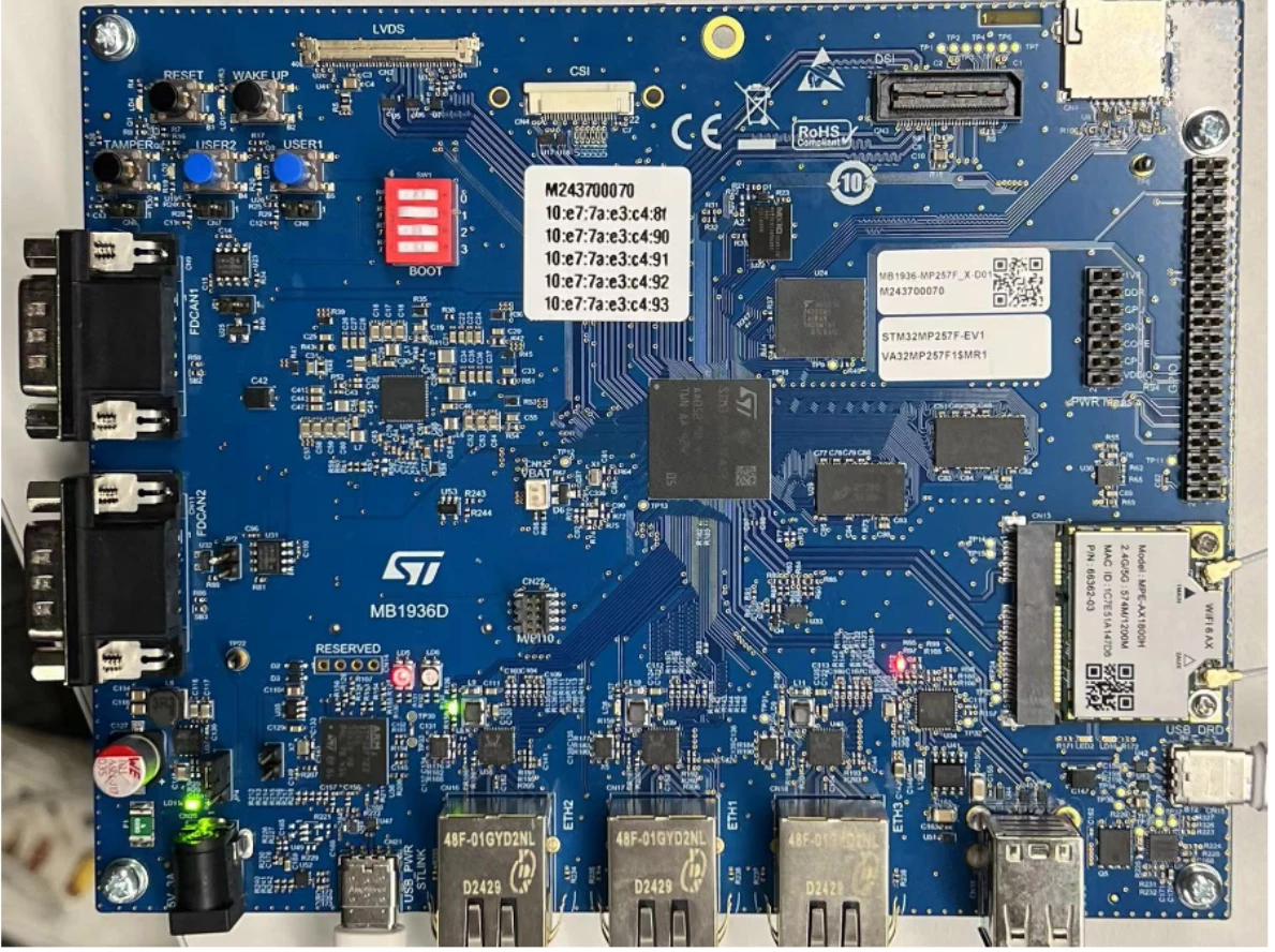

Problems using mini PCIe MT7921 wireless network card with SMT32MP257F-EV1
HI:
I install the mini PCIe MT7921 wireless network card on stm32mp257f-ev1 board.
root@stm32mp2:/# lspci
00:00.0 PCI bridge: Synopsys, Inc. Device 0550 (rev 01)
01:00.0 Network controller: MEDIATEK Corp. MT7921 802.11ax PCI Express Wireless Network Adapter

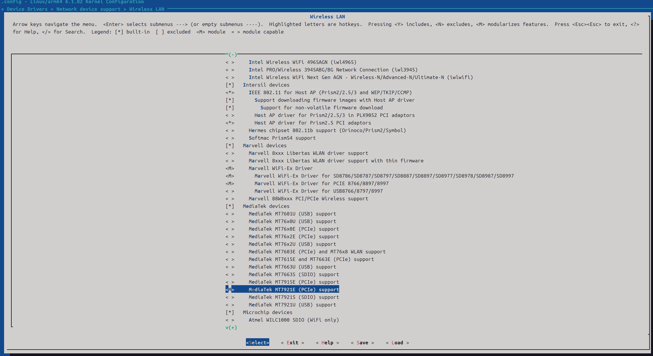

The device is normal.configure the kernel and use MT2791(pcie) ,after compilation, update the kernel and modules using the scp command.

The MT7921 isn't working properly. Please help me analyze the reasons! Thanks a lot!

The firmware of MT7921 is incorrect.repalced with RTL8188EE,it can be used now.
