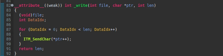

  • Edited the int _write() function in syscalls.c to redirect output to ITM

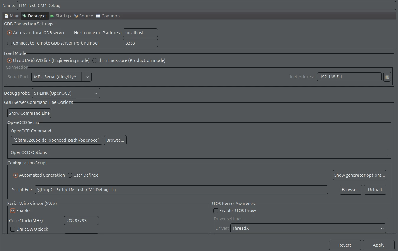

  • Enabled Serial Wire Viewer (SWV) in the debug configuration.Screenshot from 2025-10-28 11-28-45.png
  • Set the core clock frequency in the debugger to match the MCU clock (as configured in the .ioc file).
These are the typical steps I follow to enable ITM output.
Is there anything else required to get correct SWV output?
Am I missing any configuration or initialization step specific to the STM32MP1 series?
