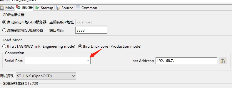

I use cudeide v1.8 in win10 and i debug m4 in load mode thru linux core(production mode). i configure it but i cant find any port when i chose serial port. it is bug?
0693W00000HnlIXQAZ.pngand i try use it in ubuntu and it work....so :sad_but_relieved_face:

Hello @Xxiao.3​ ,
This behavior normally happens in Windows 10 if you have a Virtual Machine running that already uses the ports created by the board.
In these case, the ports are invisible for Windows because they are linked to the Virtual Machine.
I tried again on my Win10 and I got the same behavior than you.
If I "Disconnect" the two ports from the virtual machine, Windows can see one of them again:
(You have to close the debug window and open it again).
Hope it helps you,
Regards,
Kevin

i turn off vm but it also cant find any serial:dizzy_face: . but cubeide v1.4 is work in win10.

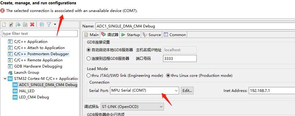

0693W00000Hoxx5QAB.pngmy board is make for myself ,157d's debug uart connect CH340. sorry i not use discovery board. but it not work in cubeide v1.8 under win10. but now i can find but it cannot connect. i can use mobaxtrem connect com7 and debug.

my pc can find com7. i can use com7 debug uboot and kernel. but cudeide v1.8 cant connect it.0693W00000Hp7NHQAZ.png0693W00000Hp7NCQAZ.png0693W00000Hp7NMQAZ.pngi can use the com7 for debug in putty, even if i close putty cude cant connect it.0693W00000Hp7NWQAZ.png

I understand you have developed a board based onto STM15x and may be you have your own hardware implementation of the Linux console.
In STM32CubeIDE Linux console is discovered searching first STMicroelectronics or FTDI console, corresponding to STLink Virtual COM Port.
In your case I would recommend to force the console with menu:
Window > Preferences > STM32Cube > MPU Serial
enable Remove Filter and select your console.
Hope this help,
LudovicR

i enable  Remove Filter  but it not find my com port. but i plug in 157c-dk2, cubeide will find it. so i dont know what cant find my com port.:face_with_tears_of_joy:
