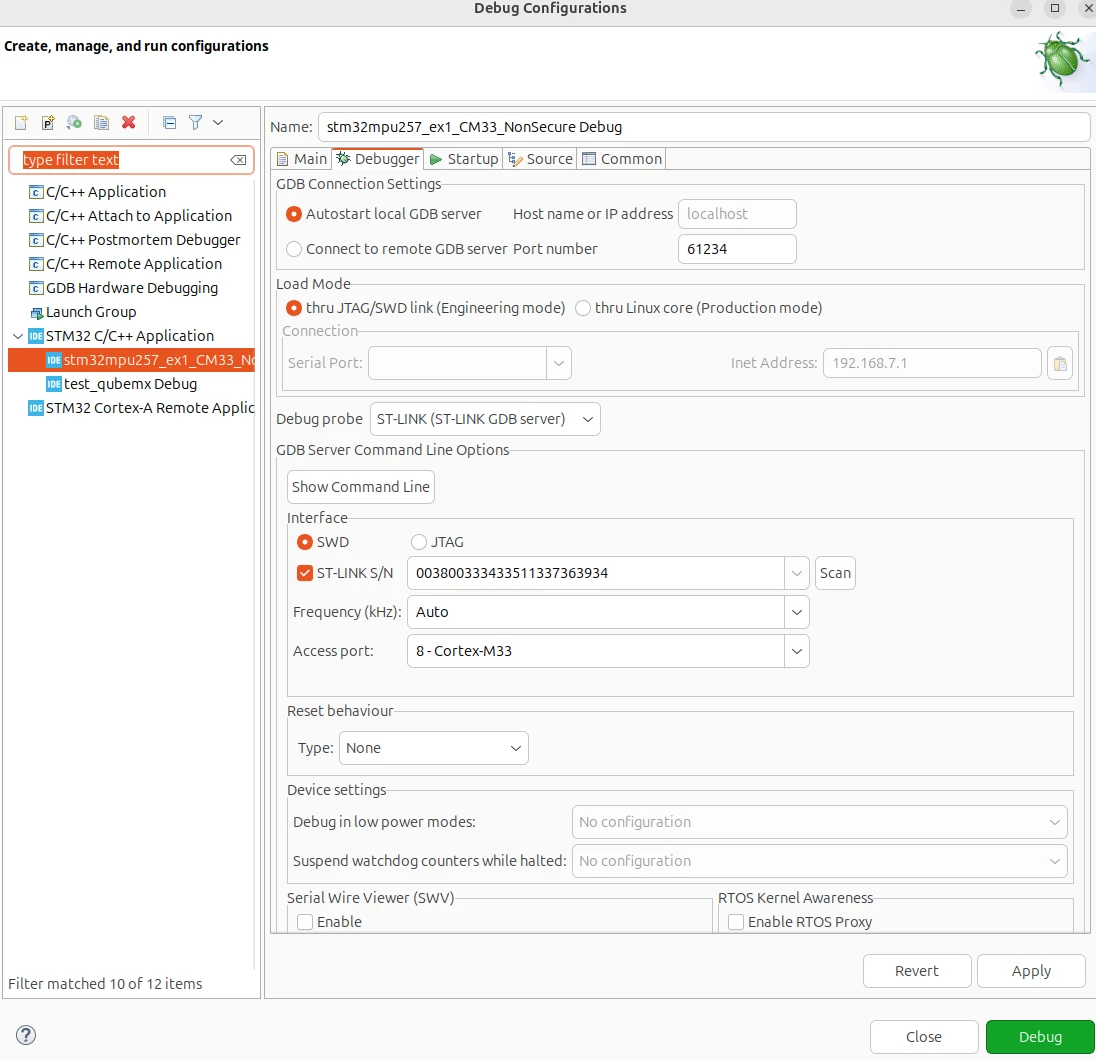

how to to flash stm32mp257-DK in baremetal with cube ide ?
STM32CubeIDE
Version: 2.1.1
Build: 28236_20260312_0043 (UTC)
How can I make sense of this ?
TMicroelectronics ST-LINK GDB server. Version 7.13.0 Copyright (c) 2026, STMicroelectronics. All rights reserved.  Starting server with the following options:
Persistent Mode
: Disabled
Logging Level
: 1
Listen Port Number
: 61234
Status Refresh Delay
: 15s
Verbose Mode
: Disabled
SWD Debug
: Enabled  Waiting for debugger connection... Debugger connected Waiting for debugger connection... Debugger connected Waiting for debugger connection...
STM32CubeProgrammer v2.22.0
Log output file:

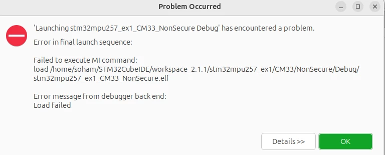

/tmp/STM32CubeProgrammer_Xj0e11.log Error: Unable to connect to the target device, Access port is not valid. Encountered Error when opening /home/soham/st/stm32cubeide_2.1.1/plugins/com.st.stm32cube.ide.mcu.externaltools.cubeprogrammer.linux64_2.2.400.202601091506/tools/bin/STM32_Programmer_CLI Shutting down... Exit.
I have added the "monitor flash mass_erase" to starter as explained in this thread,

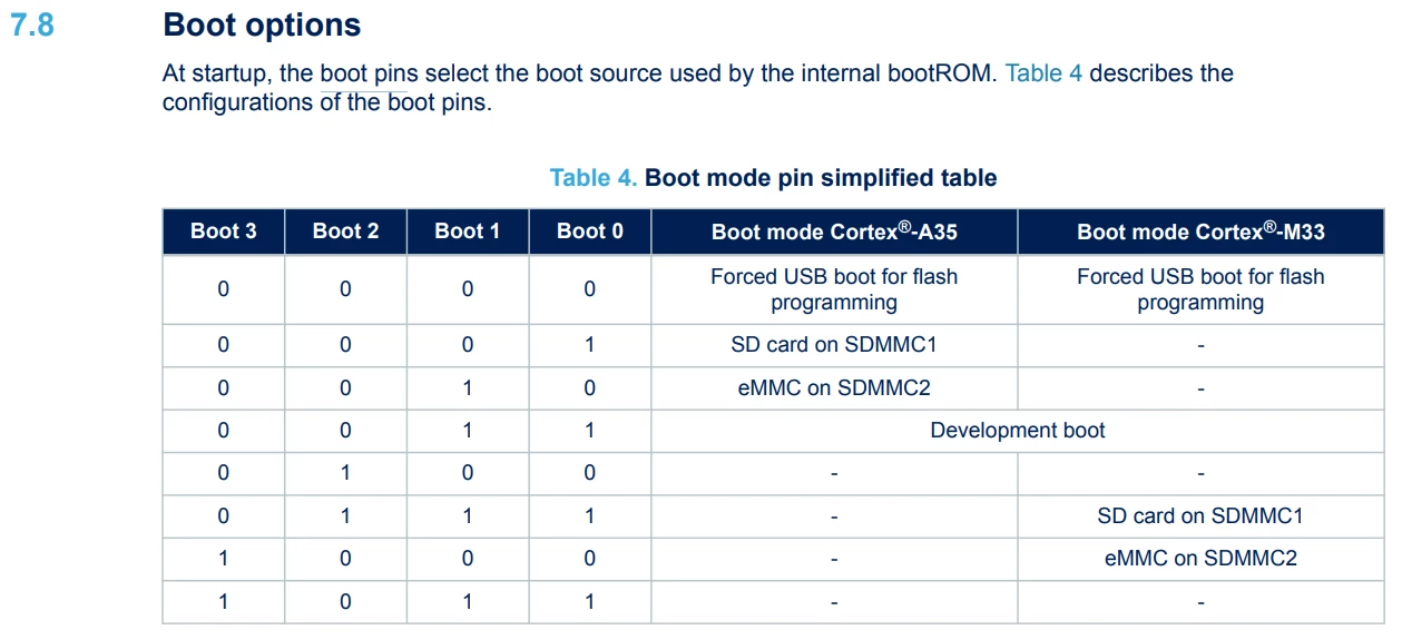

I have set the boot switches into dev mode 0011:

HI  @maths
bare-metal on cortex-A35 for STM32MP25 is not supported. It is not planned, but maybe it will come this year bare-metal support for Cortex-A35 on STM32MP21.
In any case, unlike STM32 MCUs, on STM32MP platforms, it is NOT possible to Flash (external Flash) using JTAG/SWD.
For Cortex-M33 SW, STM32MP products external Flash could be up with SSH (RJ45 or ETHoverUSB) which need to have Linux running on the platform or using USB with CubeProgrammer.
https://wiki.st.com/stm32mpu/wiki/Getting_started/STM32MP2_boards/STM32MP257x-DK/Develop_on_Arm_Cortex-M33/Modify,_rebuild_and_reload_the_firmware
Otherwise, OpenSTLinux image build with Yocto is flashed with CubeProgrammer using USB (no involvement of CubeIDE).
https://wiki.st.com/stm32mpu/wiki/Getting_started/STM32MP2_boards/STM32MP257x-DK/Let%27s_start/Populate_the_target_and_boot_the_image
Regards.

mathsAuthor
Aug 22, 2026 5:04 PM UTC
yes, But
"STM32CubeIDE requires a connection to Linux running on an STM32MP2 device though a serial connection."
WHy is linux needed to write into flash ? isn't there an easier way of writing into flash ?
 It can't reach the board : " [Debugger]: The inet address '192.168.7.1' is not reachable."
The board does not have a default IP configured for its ethernet interface, I configured it but couldn't connect either.
I tried configuring the IP tables, I still can't ping the board.
PatrickF
PatrickFBest answer
Aug 22, 2026 5:08 PM UTC
HI  @maths
Regards.
