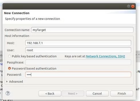

Following description of setup of debug session uses ethernet connection, so as a first step obtain ip adress of DK2 (eth0 or usb0 in case of ethernet via usb).
Setup a new SSH session

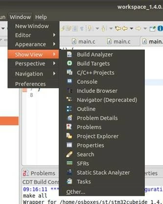

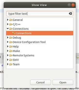

Windows > Show View > Other > Connections
The connection name will used later in debug session, host ip is the one obtained earlier, both User and password is root0693W000000VYq8QAG.jpg

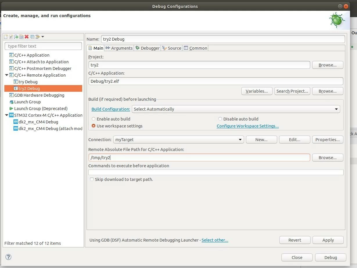

Then start debug configuration:
As connection use previous one,
And path on DK2, where your code will be placed and debugged

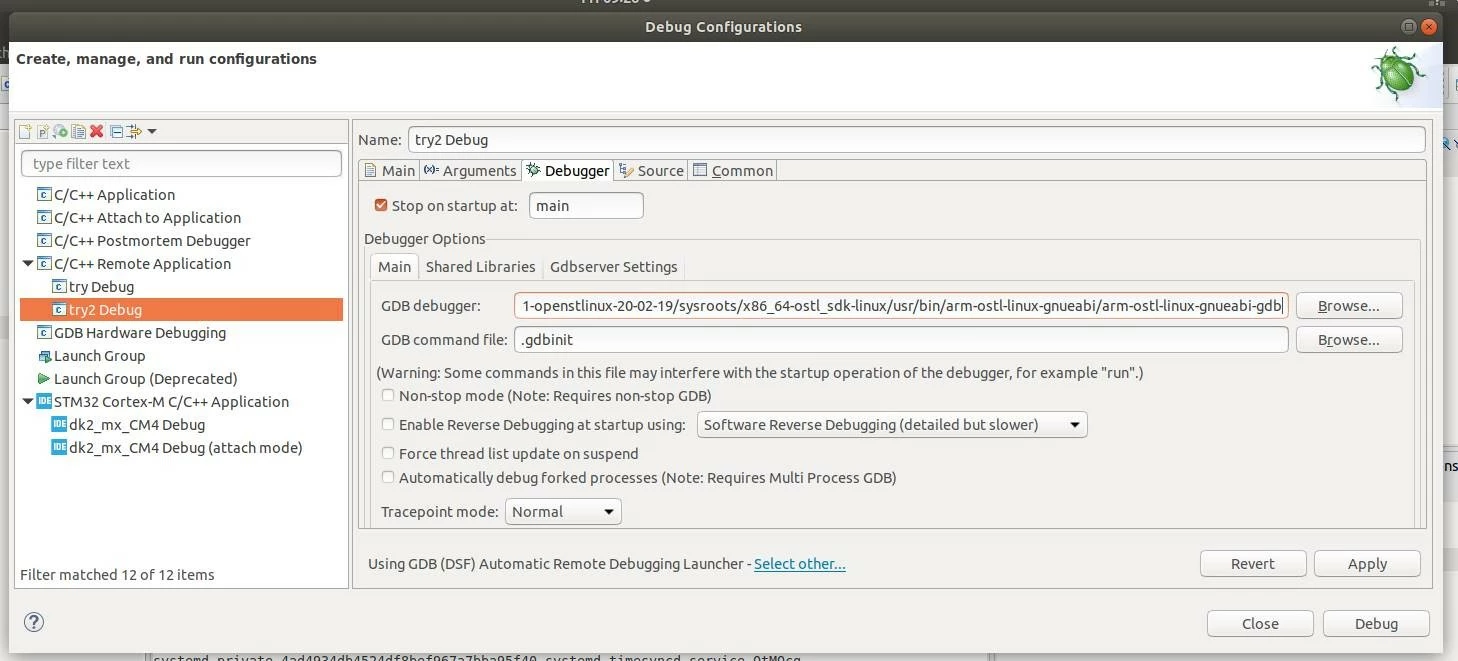

0693W000000VYu0QAG.jpg As last step insert path to GDB debugger
( in SDK in developer package), e.g. /home/osboxes/STM32MPU_workspace/STM32MP15-Ecosystem-v1.2.0/Developer-Package/SDK/sysroots/x86_64-ostl_sdk-linux/usr/bin/arm-ostl-linux-gnueabi/arm-ostl-linux-gnueabi-gdb
GDB command file leave as it is
Now it's all done, Debug!

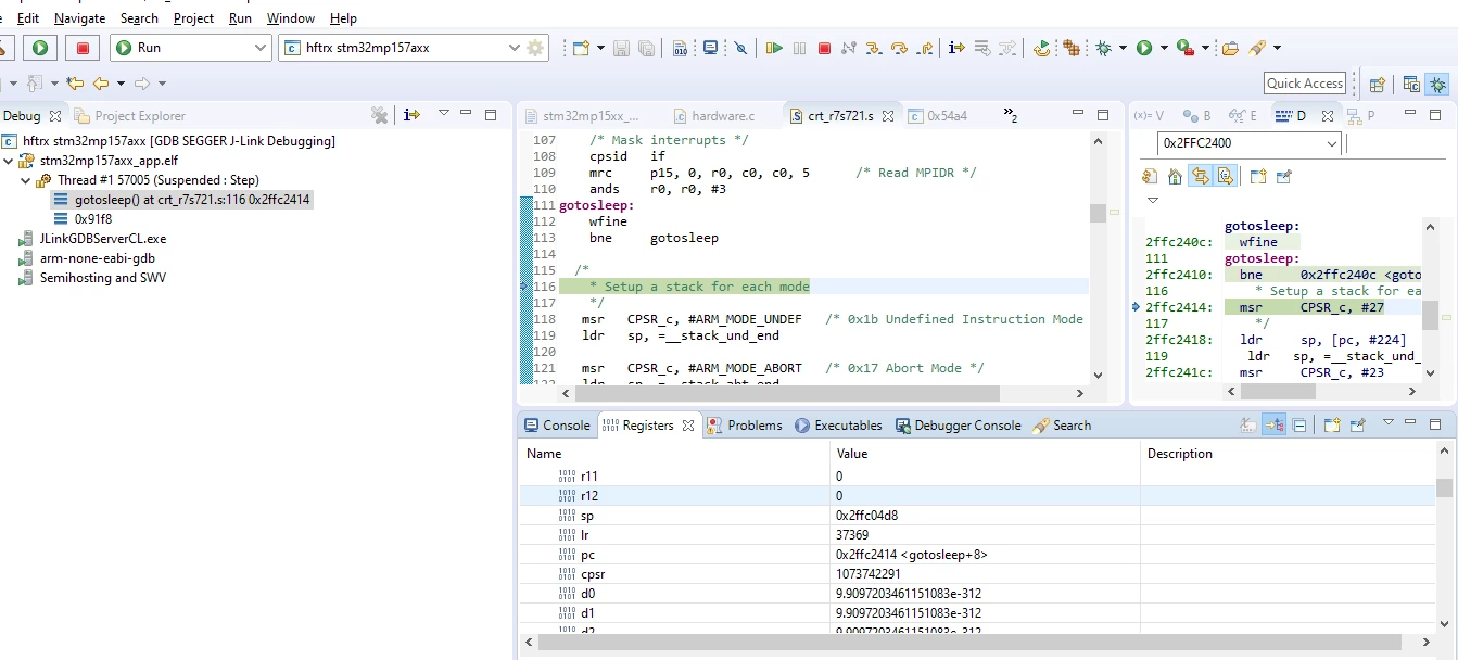

0693W000000VnQ5QAK.pngHello.
If you use J-Link and bare-metal environment - A7 core debugging is work (with few strange effects like all pins toggle in my case).
r7s7... - is a start-up code name from Renesas A9 processor with enough functionality.
ST-Link can not help in this job.
NOTE: memory addresses on picture are wrong for loader, only one value valid for region start -
0x2FFC2500. I am stops on this problem around half of month
MEMORY
 FLASH (rx) 	: ORIGIN = 0x70000000, LENGTH = 4M		/* W25Q32FVZPIG */
 DDR3 (rwx) 	: ORIGIN = 0xC0000000, LENGTH = 256M 	/* DDR3 single chip NT5CC128M16IP-DI */
 RAM (rwx)	: ORIGIN = 0x2FFC2500, LENGTH = 0x00039B00	/* SYSRAM - 256k - 16k - 9k - 256 B */
 TTB (rwx) 	: ORIGIN = 0x2FFFC000, LENGTH = 16k		/* last 16 kB SYSRAM for TTB */
  https://community.st.com/s/question/0D50X0000BiDo0fSQC/stm32mp157aab-failed-to-boot-from-nor-qspi-baremetal?t=1575552683743
 Load address is ALWAYS 0x2FFC2400 for FSBL, whatever you put in the header (it is ignored for FSBL).
 Entry point in the header could be anywhere after the header (i.e. 0x2FFC2500) and the end of the SYSRAM
 I recommend to compile your FSBL SW to fit with a region starting from 0x2FFC2500 (with a size of max 247KB minus 256 for header).
 Entry point will depend on your SW startup.s construction, it is not always at the very first address.
