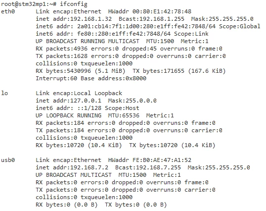

In the board console, what is the result of ifconfig command?

ifconfig on board showed 3 interfaces: usb0(with set ip), loopback and eth0(which ip i set)

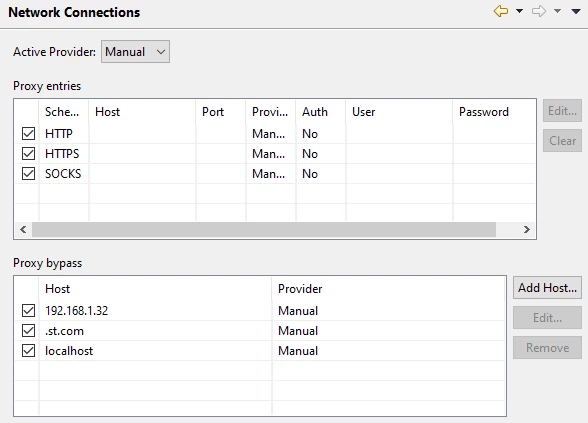

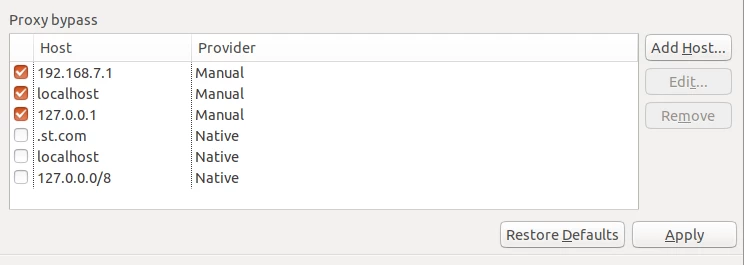

In my case I had to change connection settings and add proxy bypass of the board.
Could you verify on your side?

There is one thing i don't quite understand, if am using windows for desktop, i need to instal VM with ubuntu to do anything further ?
Like i won't be able to program thru linux this board if i dont set porxy on vm ? Can you send me link to some tutorial which explains this ? xD
I don't quite understand why is this necessary :(

I have the same issue as @MDzie.1​ but I didn't manage to solve it. I connected the board with an ethernet over USB connection. ifconfig on board shows 3 interfaces: usb0, loopback and eth0. Since, it didn't work I changed connection settings and addedd proxy bypass of the board as follow. Hower it still doesn't work "Inet address 192.168.7.2 is not reachable".

The address 192.168.7.2 is indeed strange - should be 192.168.7.1.
What addresses do you see running ifconfig? Could you provide it?
Do you use proxy? (https://wiki.st.com/stm32mpu/wiki/How_to_avoid_proxy_issues)

With the ifconfig command I have, the following result.0693W000001q9gxQAA.png I don't use a proxy. For information, when I connect STM32MP1 with Ethernet and I configure the network connection as follows, it works.
