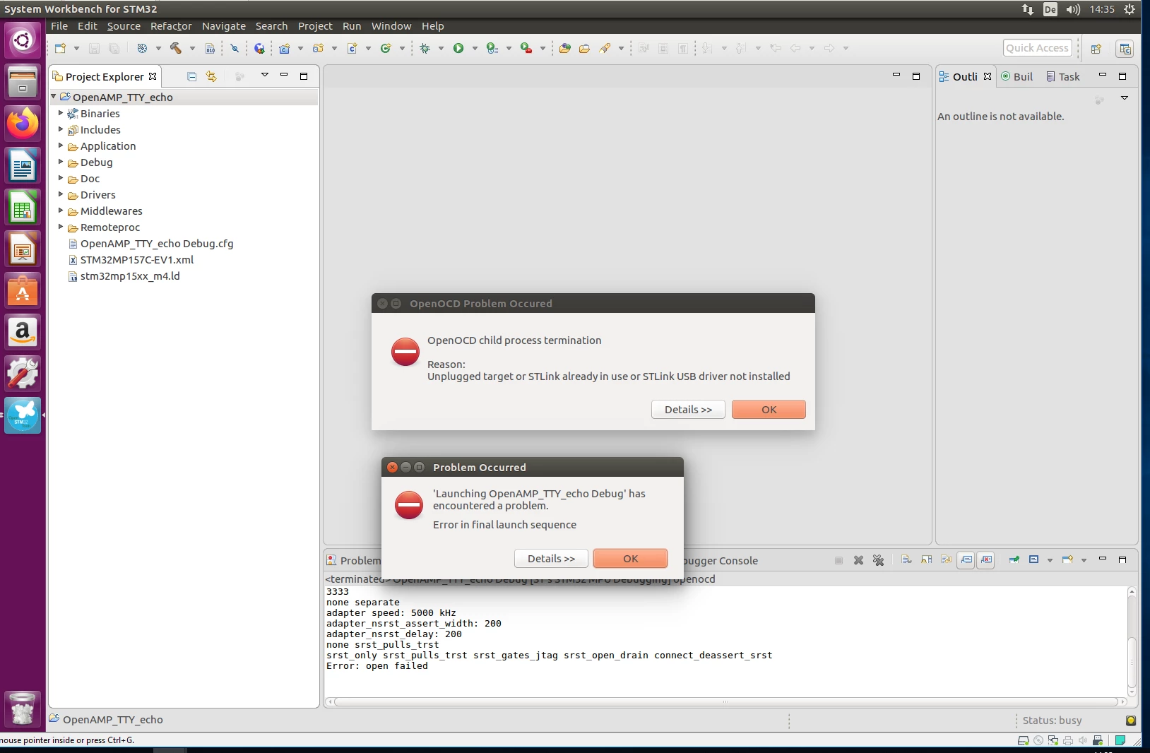

FSchr.1
FSchr.1Author
Dec 13, 2019 1:50 PM UTC
Thank you Olivier
With your hint I came a step further. It seems that the object file has been downloaded to the target.
But unfortunately I get further error, you see below and I am still not at the goal.
What is the exactly needed system configuration for this demo debug session ?
In my system configuration the evaluation board is connected over Ethernet to the development PC running Ubuntu 16.04 under VM-Ware. Then I also have a RS232 connection trough UART4 port of the evaluation board.
Do I also have to connect the ST-Link V2.1 to my Linux PC ?
Is there a description how set-up the ST-Link V2.1 on the VM-Ware Ubuntu machine ?
Fortunat
Olivier GALLIEN
Olivier GALLIENBest answer
Dec 13, 2019 1:54 PM UTC
Yes you need also to connect the STLINK on CN4 of the daugther board.
Olivier

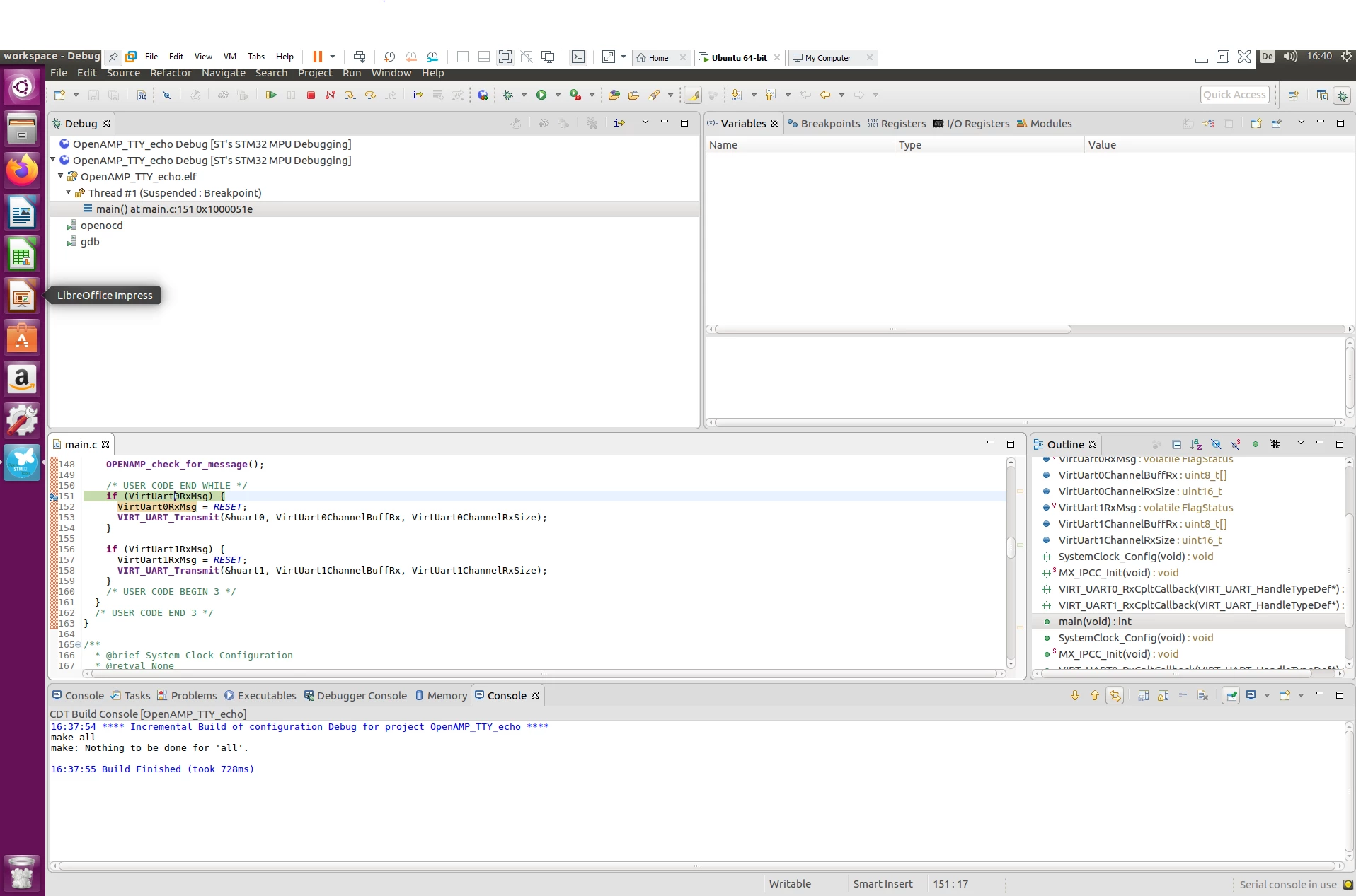

FSchr.1
FSchr.1Author
Dec 13, 2019 3:44 PM UTC
Hi Olivier
Thank you for your answer
It seems that I have made a step forward.
As you see below, it seems that the debugging of the Cortex M4 software is now working.
Olivier GALLIEN
Dec 13, 2019 3:47 PM UTC
I confirm :smiling_face_with_smiling_eyes:
Good debug !
