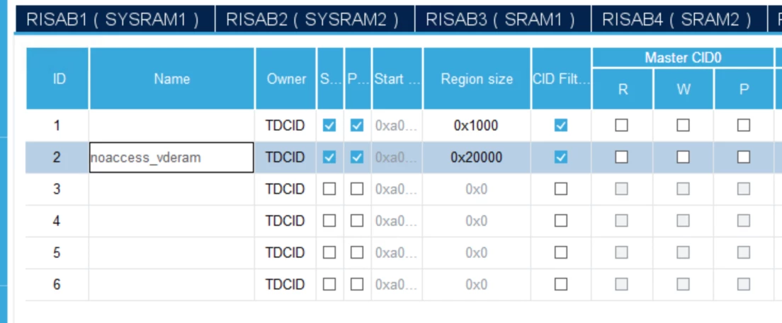

Oct 3, 2026 11:08 PM UTC
I have also encountered this issue. The root cause seems to be in the RIF section of the CubeMX DB: It starts the VDERAM region 4K earlier than it should, probably due to some sort of parsing error that didn’t count the 4K DDR_param region in RETRAM when generating the DB XML.
To work around in CubeMX (6.18.1) it seems like you can:
  1. Leave the name for the first row in RISAB6 blank, set size to 0x1000.
  2. Following regions in the table will be placed accordingly.
  3. Region 2 will inherit the settings from Region 1, so just make them match (see image)
I don’t know whether this behavior will remain consistent for future CubeMX, though I do think the blank row inheriting is probably a bug in its own right.
