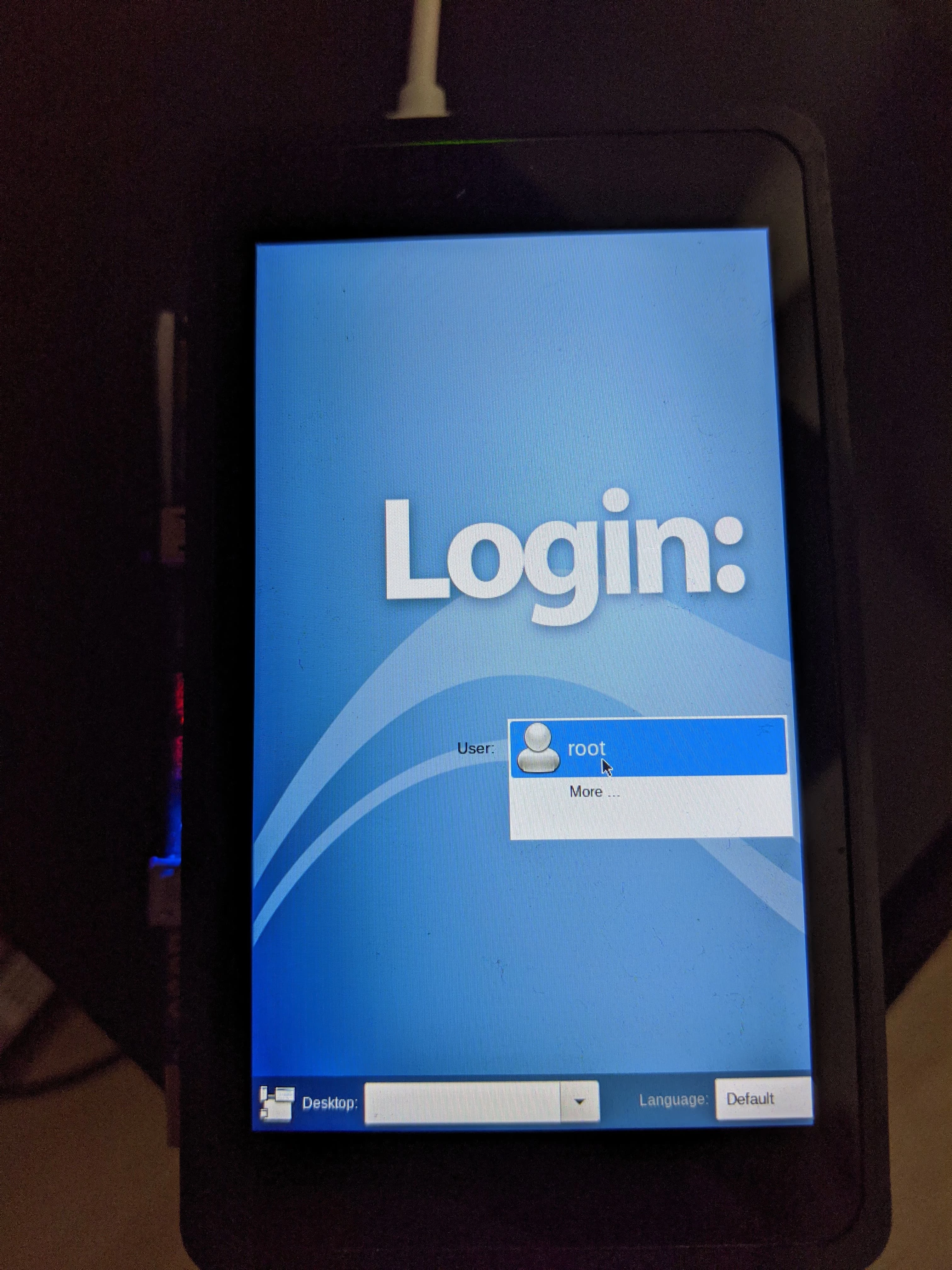

La1
March 21, 2020
Hi, I also build st-example-image-x11 and flashed it on stm32mp157 DK2. But when device boots, it shows login screen with "root" user and i can't log in and move to desktop. Did you have same problem ? How you logged in ? Did you change something in local.conf file or bblayers.conf ?
Here is the screen:0693W000000UR1zQAG.jpg
Adrian1
Adrian1Author
March 22, 2020
Hi, You must configure start-up files in / etc / lxdm:
https://wiki.archlinux.org/index.php/LXDM
Regards,
Adrian
La1
March 22, 2020
Ok, thanks, i will try :)
La1
March 23, 2020
When you deploy your image on board, you was able to log in, or do something ?
Maybe i compiled it wrong. When i click on root user, black screen appear for few seconds and then system again return to login page.
Adrian1
Adrian1Author
March 23, 2020
Lxdm after click to root, runs PreLogin and PostLogin files, when it is empty it back to logging page. You moust to configure them like in instructions on:
Regards,
Adrian
