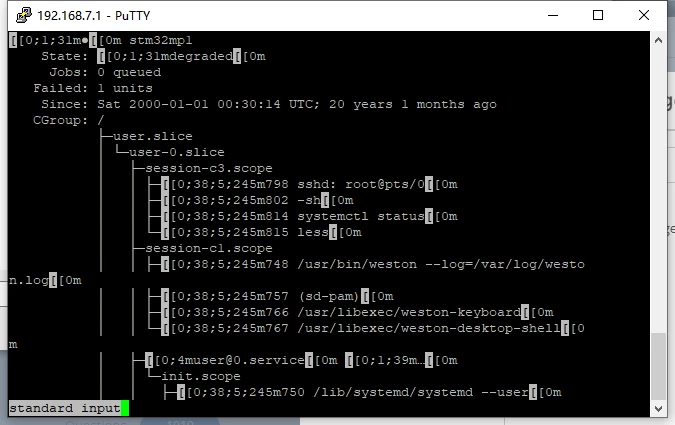

Why systemdctl output of strange characters
  • November 6, 2020
  • 1 reply
  • 1027 views
These should be escape characters and should not be displayed0693W000005AY0yQAG.png
1 reply
AntonioST
November 6, 2020
The escape characters are supposed to provide colored output and bold+italic characters.
It is possible that PuTTY does not recognize them due to different character set or language setup.
I have searched for specific flags to systemctl to disable such "beautified" output, but apparently there are not!
As a workaround you can pipe the output through another command, so systemctl automatically disables the "beautified" output:
systemctl | cat
