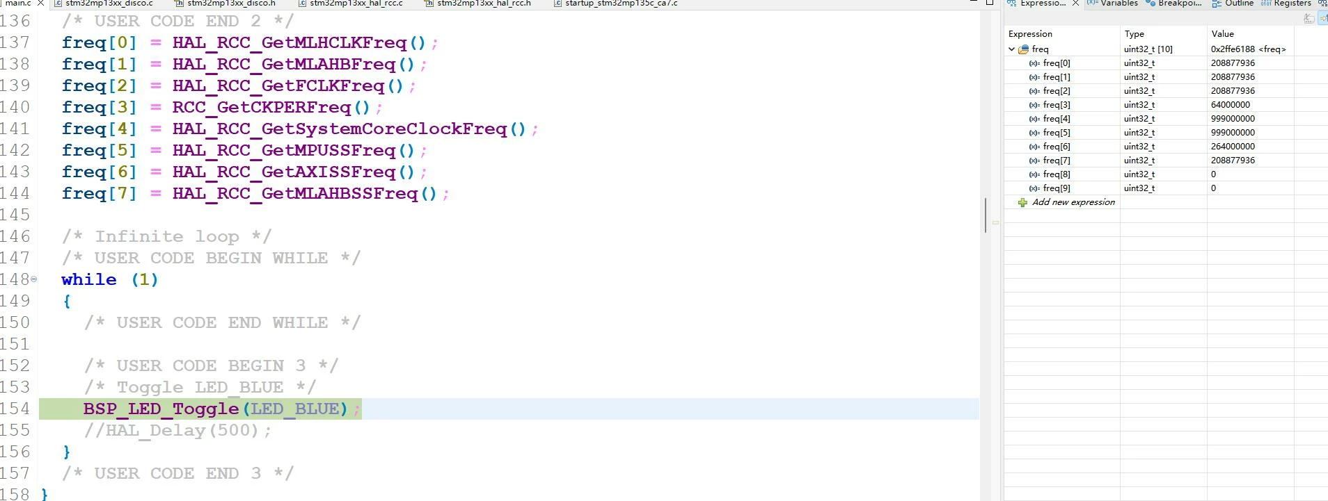

my code only made changes the io, no rtos, no interrupt, but it cost over 1 us.  the picture is that io sta. and clockp1.jpgp2.jpg

maybe you missed to enable the I & D caches ?

oh,you are right, after i enable the cache,the runtime speed doubled.

only doubled ?
I guess only Instruction cache were enabled (as it is simple as set a bit).
Data cache might bring more perf (e.g. write to GPIO section will be posted, so 0 waits), but this need to setup MMU with correct regions (usually sections attributes are : memories as "NORMAL", peripherals as "DEVICE" ).
I'm not fully knowledgeable on how to do it with HAL, but I assume functions to do such exists (maybe examples).
