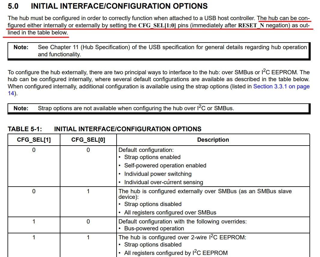

I can see in the data sheet that there are two bus configurations abilities.
  • I2C EEPROM
  • SMBus
I don't know which one should be used. Let's look at the data sheet.
This explains that the pins CFG_SEL[0] and CFG_SEL[1] needs to be low or high before the pin RESET_N goes low.

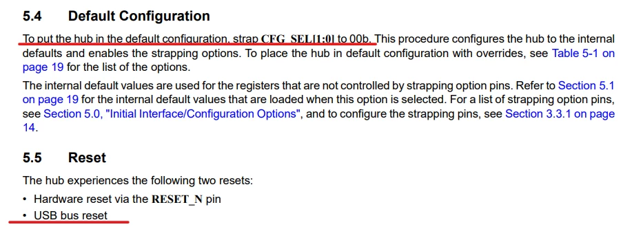

And the reset can be done through the USB differential lines.

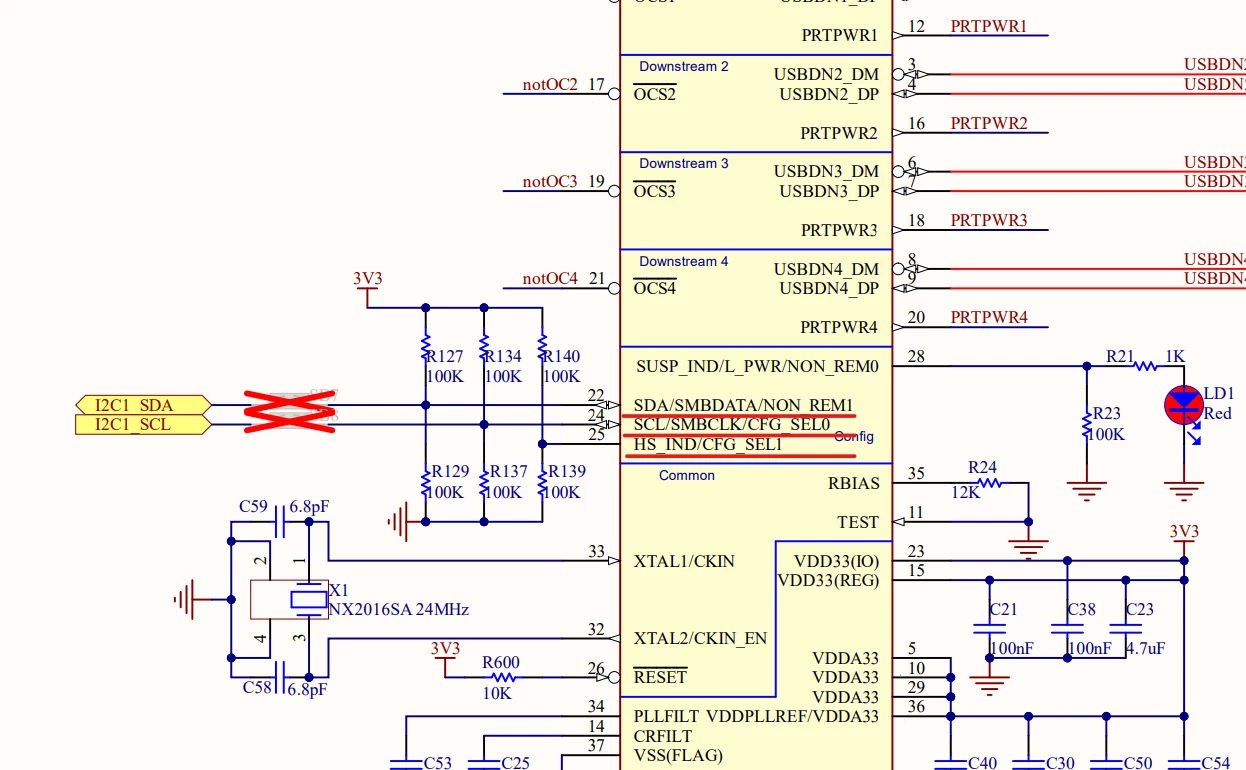

I don't understand this construction. I know that I2C should have a pull-up resistor of 4.7 kOhm, but here we have a 100 kOhm on both GND and 3V3, which makes this a voltage divider.

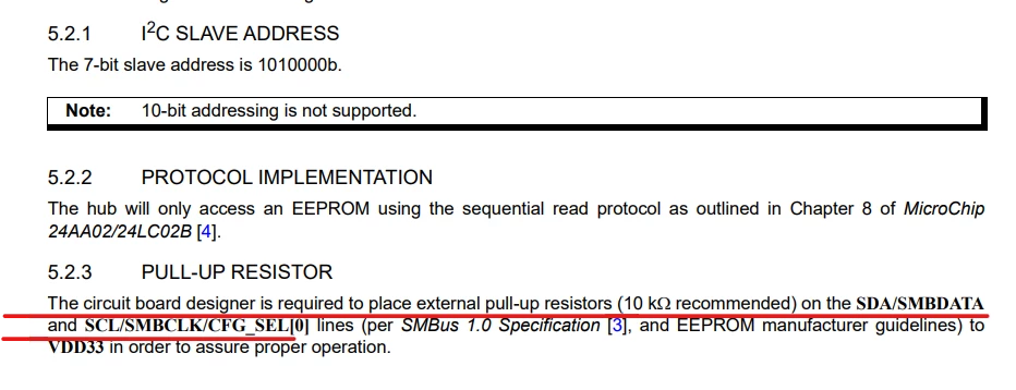

And the data sheet says that 10 kOhm should be the value for pull-up resistors.

Red cross (read it as 'cutout') and DNF is the same, mean the component placed on the PCB is not fitted, i.e. circuit is OPEN (This could explain the mistake you made around HSE interpretation, which is now OK on your latest proposal).
Same for Solder Bridges (SBxx), when not fitted or greyed, it mean circuit is OPEN.
Usually DNF components or solder bridges are options to allows some specific modes trials or different board behavior.

DNF means Does Not Fit. Does that mens that it could not fit the HW design, or it was removed? So in this case, it's only 100 kOhm pull-downs?
I'm looking at the en.mb1272-dk1-c03-schematic.pdf schematics.

Yes, DNF mean Do Not Fit, i.e. component is not populated during board assembly.
The Bill Of Material is the reference for the 'not fitted'
