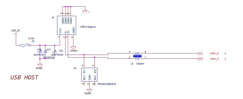

Why does the USB mouse not work on STM32MP157 USB1?
We have a design with a USB HOST, the schematic is shown below, And the system is Linux 4.19. We have add some configuration about USB HID as below:
 2 CONFIG_HID=y
 3 CONFIG_HID_GENERIC=y
 4 CONFIG_USB_HID=y
 5 CONFIG_USB_HIDDEV=y
 6 CONFIG_USB_KBD=y
 7 CONFIG_USB_MOUSE=y
If we connect the USB Mouse directly to J4, it does not work(The LED on the USB mouse is on), but the USB Stick works;

If we connect a USB Hub to J4, and connect the USB Mouse to the USB hub, it works.

I suspect the OHCI is not enabled, but "dmesg | grep usb" does not show it. You should try "dmesg | grep -i ohci"
The wiki page
https://wiki.st.com/stm32mpu/wiki/USBH_device_tree_configuration
reports the settings for enabling ohci.
Please note that ohci is not enabled on the ST boards because both include on-board a USB hub.

Thank you for your reply, AntonioST!
After enabling ohci, the USB mouse works.
