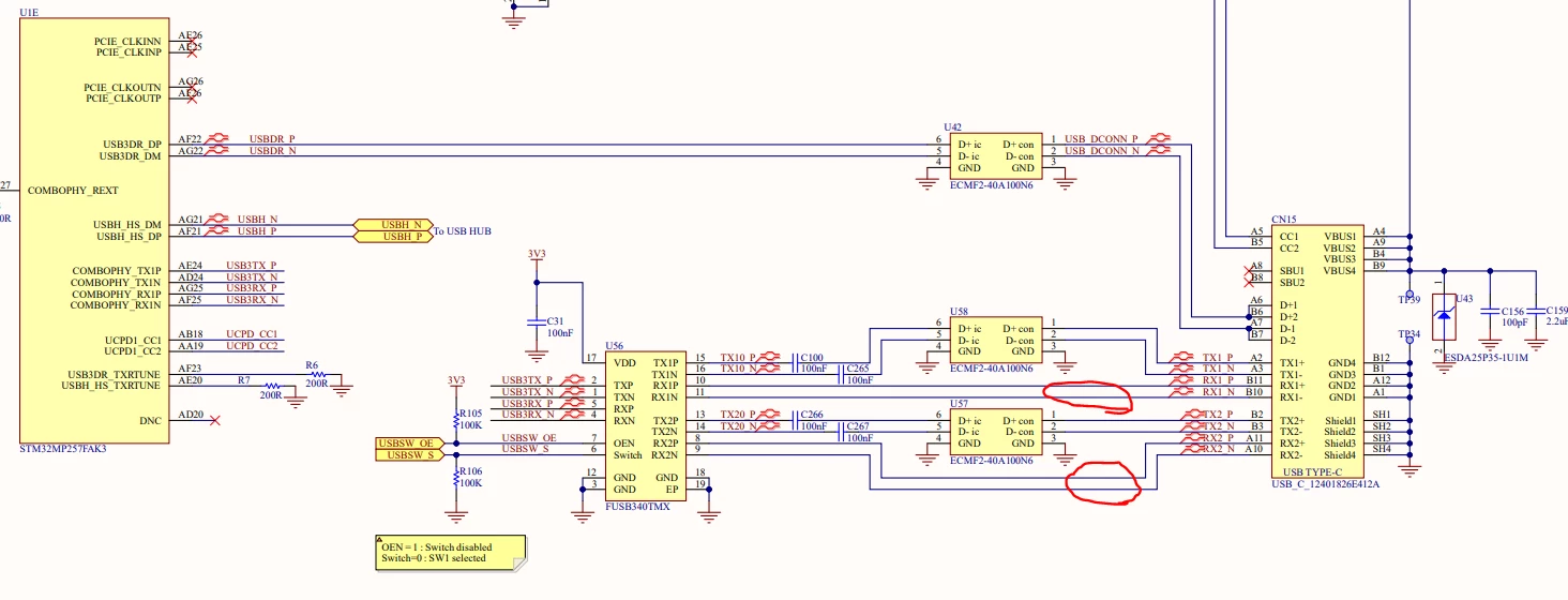

Why does STM32MP257F-DK not having EMI-filters on RX lines for USB 3.0?
Can it be like a common standard that the transmitter TX should always have:
  • AC capacitors
  • ESD protection
  • EMI-filtering
And the RX does not need anything of those, because it’s assuming that their transmitter already having these implemented?
This picture is from mb1605-mp257f-c01-schematic.pdf

Hi ​@Windows
Probably multiple explanations (guess):
  • There is no product related emission on RX lines, so no need of EMI filter to fulfill product standards (FCC or similar).
  • There is already ESD protection inside FUSB340 switch RX
  • The serie capacitor on TX might need to be protected from ESD (I’m not sure about that)
Regards.

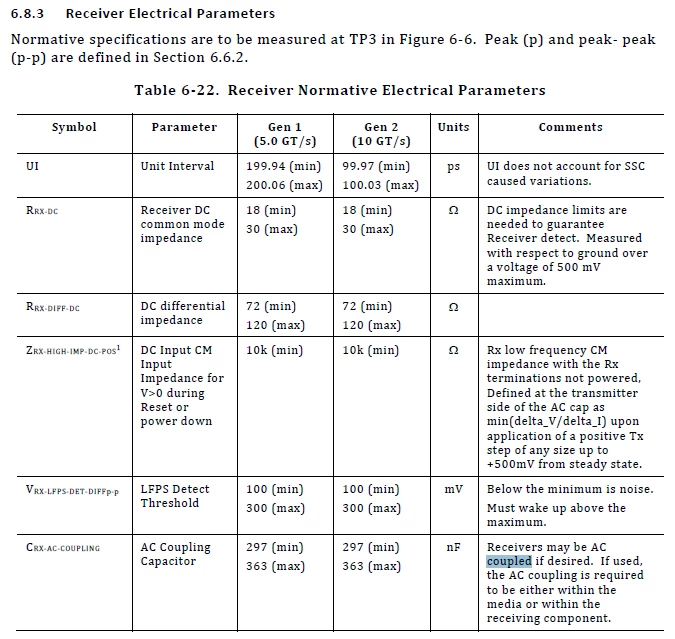

Hi ​@Windows
Checking USB3 standard in  USB 3.2 Revision 1.1 - June 2022 | USB-IF, section 6.8.3 Receiver Electrical Parameters
Table 6-22
On RX, it seems optional.
To give better visibility on the answered topics, please click on "Best answer" on the reply which solved your issue or answered your question.Best regards,FBL
WindowsAuthor
Senior
Jul 9, 2026 3:27 PM UTC
​@FBL
Thank you so much. Yes, the RX lines are optional for AC capacitors.
But why did ST not implement EMI filter for RX lines as well?  Just wondering.

WindowsAuthor
Senior
Jul 23, 2026 8:58 PM UTC
Thank you ​@PatrickF
Yes. The FUSB340 have internal 2kV ESD protection. But that’s is only for packaging.
According to the getting started manual for MP2, it recommends to use EMI filtering on both RX and TX.
