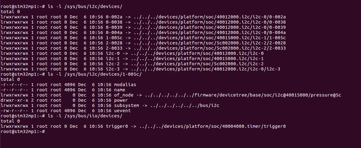

Why does Linux Kernel not apply ST-sensor driver to pressure sensor?
I connected an external sensor via i2c and modified the device tree dk2 with following addition:
&i2c5 {
	status = "okay";
	clock-frequency = <100000>;
	pinctrl-names = "default", "sleep";
	pinctrl-0 = <&i2c5_pins_a>;
	pinctrl-1 = <&i2c5_pins_sleep_a>;
	pressure@5c{
		compatible = "st,lps22hb-press";
		reg = <0x5c>;
		vdd-supply = <&v3v3>;
I am able to see the sensor on the correct address in the register but the kernel doesnt seem to recognize it as a st pressure sensor. Its also not shown in the list of iio.
I also modified the device tree dk1 like this:
&i2c5 {
	status = "okay";
the sensor is the correct one btw.
edit:
I also checked in the config that ST-sensor-Drivers are activated before building.
7 replies

NHuhs.2394
December 9, 2019
Hi Patrick,
thanks for your answer but that is exactly the documentation I used to get to the point where I am now.
It worked perfectly up to the point "Describing the BME280 in the Device Tree".
the "compatible" string should be correct as I copied it directly from the list of compatible strings in the st-sensors.txt.
p.s.: The sensor is located on a waveshare sense-hat which is connected via i2c. could that be a problem?

NHuhs.2394
December 10, 2019
Unfortunately still no success.
I'll try using a different sensor to see if results are different there.

NHuhs.2394
December 10, 2019
yes I did. everything is enabled. I also tried enabling it with <*> in menuconfig instead of building it as a module but same results
