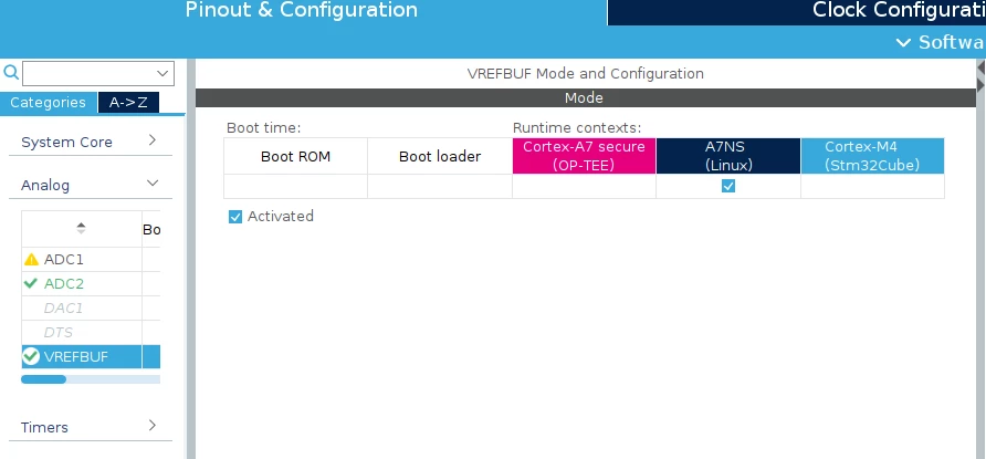

Kevin HUBER
Feb 10, 2022 15:17 UTC
Hi @msche.1​ ,
Thanks to have shared your .ioc.
To be able to get a usable value by reading the ADC, you must have a reference which is VREFBUF.
I advice you to read the reference manual (RM0436 revision 5) page 1693: https://www.st.com/resource/en/reference_manual/DM00327659-.pdf
and the ADC page on the wiki: https://wiki.st.com/stm32mpu/wiki/ADC_internal_peripheral#Features
Then you have two choices to enable VREFBUF.
  • Engineering mode (without Linux)
If you are not using linux you have to enable the VREFBUF after the ADC_Init() but before starting it:
 __HAL_RCC_VREF_CLK_ENABLE(); // Enable the VREF clock
 HAL_SYSCFG_VREFBUF_HighImpedanceConfig(SYSCFG_VREFBUF_HIGH_IMPEDANCE_DISABLE); // Disable the high impedance mode which is the default one read page 1694 of refman
 HAL_SYSCFG_VREFBUF_VoltageScalingConfig(SYSCFG_VREFBUF_VOLTAGE_SCALE1); // To set the volage to 2.5v
 HAL_SYSCFG_EnableVREFBUF(); // To enable VREFBUF
Then you must calibrate your adc before using it:
 if(HAL_ADCEx_Calibration_Start(&hadc1, ADC_CALIB_OFFSET_LINEARITY, ADC_SINGLE_ENDED) != HAL_OK)
 /* Calibration Error */
 Error_Handler();
And finally you can use the code that you wrote in your first post to read the value.
  • In Production mode (with linux running):
You have to enable VREFBUF in the DTS for making it startable by Linux, you can enable it with CubeMx.
Then you have to configure the VREFBUF, I advise you to read this page:
https://wiki.st.com/stm32mpu/wiki/Regulator_overview#Microcontroller_device_internal_regulator
In a first time, I advise you to start by testing your code in engineering mode.
Note that this is setting VREF+=2.5V, so conversion range between 0 and 2.5V.
Hope it helps,
Regards,
Kevin
