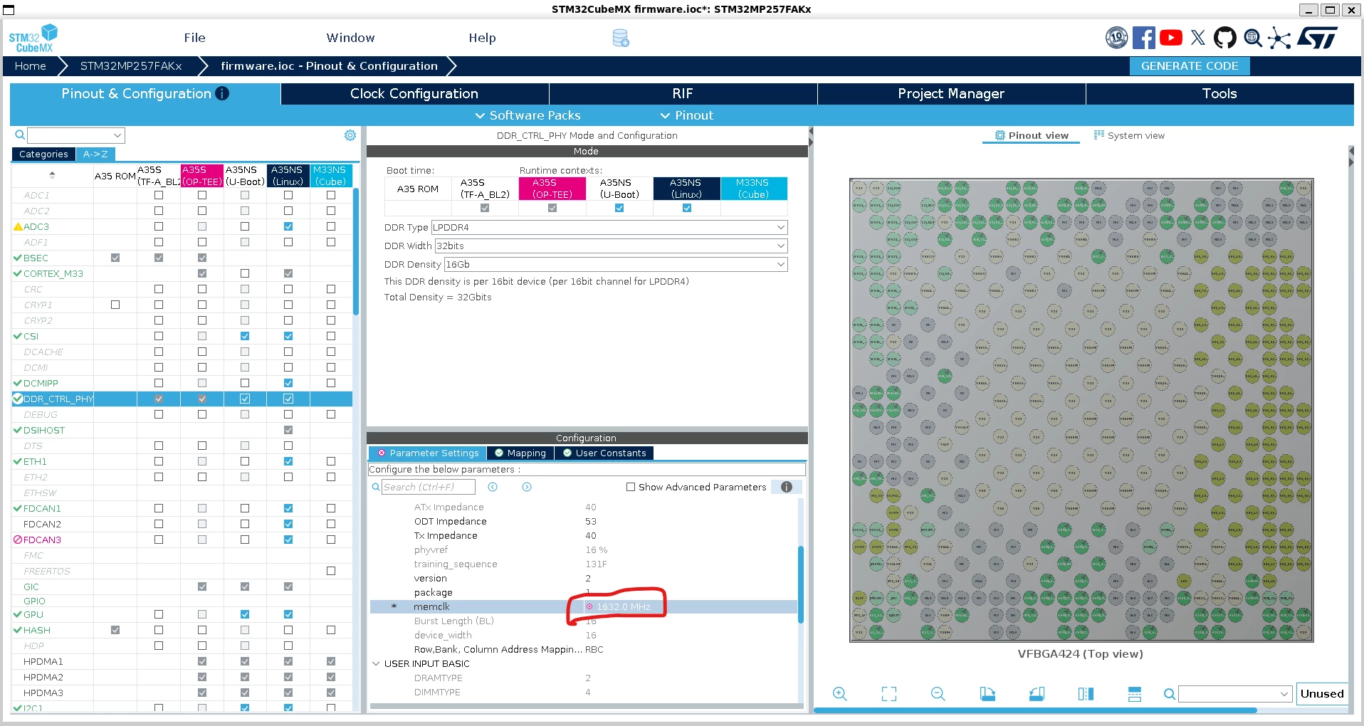

What Device Tree/Configuration of USART/UART does the MP2xROMtracesdump have?
I have built a custom board by using STM32MP257F and I want to boot on USART6.
I have not succeed to boot on USART6 when I compile my own fsbla by change the device tree of TF-A.
I got a suggestion from ST Dev team to run this ROM tracedump wiki-stm32mp-addons/MP2RomTracesDump at 6.1.0 · STMicroelectronics/wiki-stm32mp-addons · GitHub and it gave me a positive output on USART6.
The soldering was OK. The BootROM was OK and the UART6 was alive. This is the output from my USART6.

Question:
I'm planning to use USART6 as early debugging but I need to know what settings the ROMtracedump had for displaying and using USART6.
My Device Tree for TF-A have this following setting. But still, this won't work. I don't know why it won't work. Perhaps if I could know the settings fom the ROMtracedump, then I could understand why the USART6 is working as early debugging and not for my Device Tree for TF-A.

PatrickF
PatrickFBest answer
Jan 29, 2026 7:33 AM UTC
MP2RomTracesDump is a bare-metal SW, not using Device Tree.
Have you looked in details this post ?

I found an weird bug. I cannot change this value. Even if it's wrong.
STM32MP151AAC3 custom board with STM32-OS as operating system: https://github.com/DanielMartensson/STM32-ComputerSTM32MP257FAK3 custom board with STM64-OS as operating system: https://github.com/DanielMartensson/STM64-Computer
Kevin HUBER
Jan 29, 2026 5:30 PM UTC
Hello @DMårt
To fix the wrong memclk value in your DDR configuration, you have to go in "Clock Configuration" tab and update the clock divider going "To DDR", around PLL2 clock mux.
Hope it helps,

Hi @Kevin HUBER
I have set my DDR to 600 MHz in the clock configuration tab so the memclk becomes 1200 MHz.
I will now see if USART6 is working as early boot debug. Perhaps not...
Edit:
It did not work.
