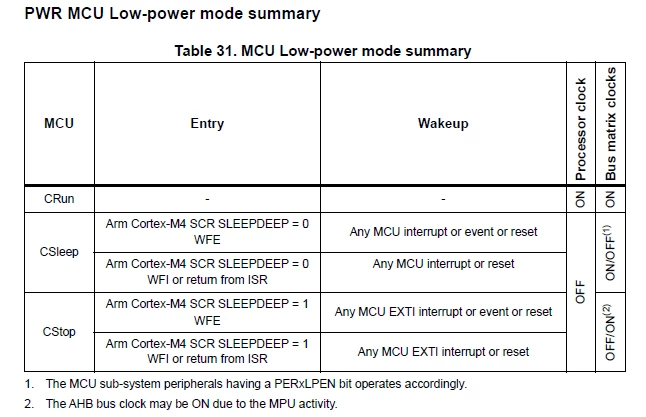

Wake-up mechanism depend on which low power mode the Cortex-M4 is:
0693W00000Y6ohmQAB.pngFor Run or Csleep, any NVIC interrupts could be used.
For CStop, which requires EXTI, please refer to RefMan "STM32MP157 EXTI Events".
I think you could use IPCC (EXTI61 or 62), HSEM_IT2 (EXTI64) or Cortex-A SEV (EXTI66) which could be triggered from Cortex-A7 actions and, when set in EXTI, could wakeup Cortex-M4 (and as well trigger NVIC interrupts in Run or CSleep).
