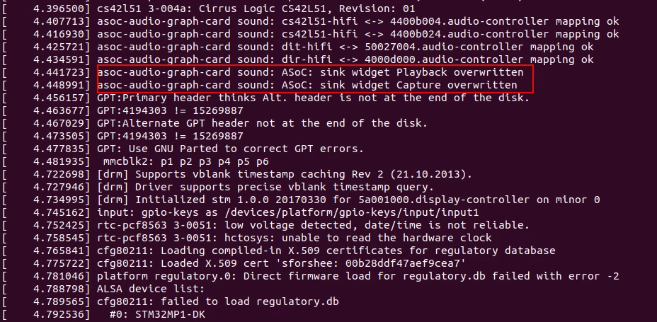

Using the CS41L51 audio chip while using SPDIF will cause the following errors.

With this device tree configuration, the following error occurs. Remove the node &sai4a_port in DASI, and audio can be used. How do I modify the node &sai4a_port
[  4.441723] asoc-audio-graph-card sound: ASoC: sink widget Playback overwritten
[  4.448991] asoc-audio-graph-card sound: ASoC: sink widget Capture overwritten

Here are 2 or 3 questions to help me to understand the problem:
1) In your DT, cs42l51 is connected to i²C4 : could you please tell me on which board you are working on ?
2) When you say that "audio can be used", does it mean that adding &sai4a_port entry from dais list breaks cs42l51 codec rx and tx and/or spdif_in ? Could you please elaborate on what works and what doesn't work, and what you want to do.

1)Based on the STM32MP157-EV1 board to make a development board of our company, the CPU uses STM32MP157D, and the PMIC is removed.The audio is based on STM32MP157C-DK2
2)Yes,&Sai4a_port will destroy the RX and TX of the CS42l51 encoder
/***The audio will work normally in this way**/
dais = <&sai2a_port &sai2b_port &spdifrx_port &i2s2_port>;
dais = <&sai4a_port &spdifrx_port &i2s2_port>;
​As long as CS42L51 and &sai4a_port are both in dasi, CS42L51 will report the following error
I think &sai4a_port and CS42L51 can run normally

We had this kind of error in the past with digital microphone DT entries : the problem was coming from dapm widget names and audio interfaces which were identicals.
It has been fixed by adding a prefix :
dmic1: dmic-1 {
 compatible = "dmic-codec";
 #sound-dai-cells = <1>;
+ sound-name-prefix = "dmic1";
 status = "okay";
Hope it will help,
