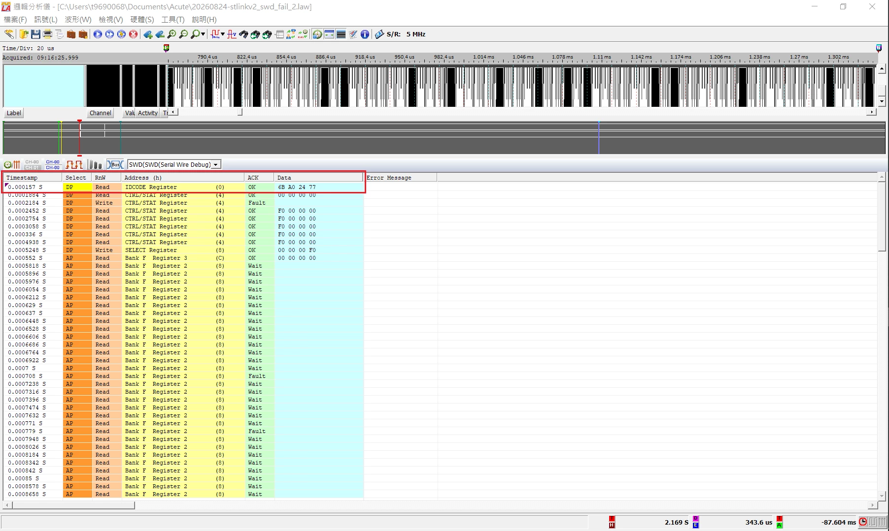

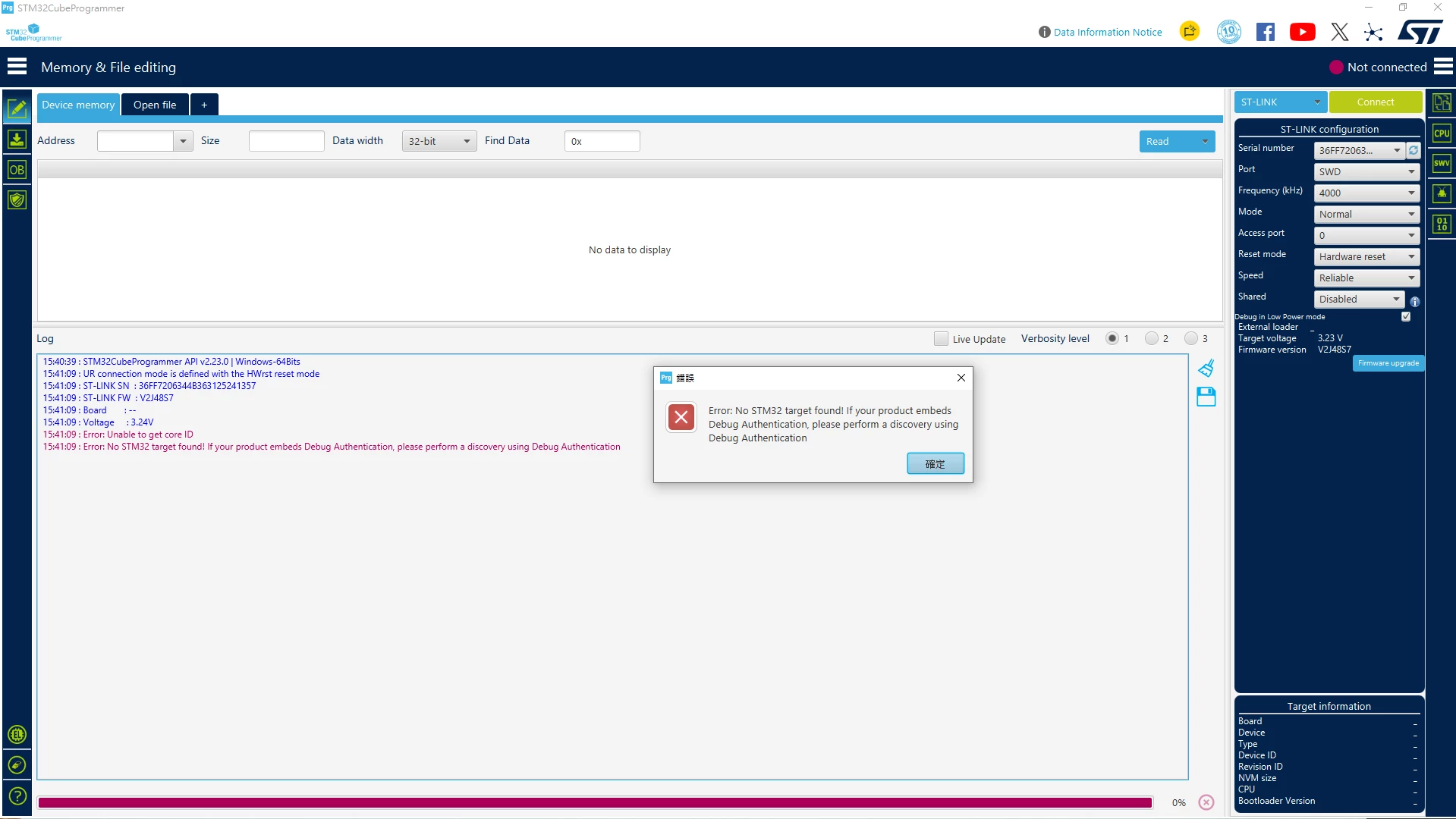

We want to verify that the circuitry of our custom motherboard (SWD) is functioning correctly. Our initial plan was to use STM32CubeProgrammer to connect to the SWD via ST-Link to obtain the CPU ID, thus proving that the circuitry is working properly. If ST-Link cannot be used for testing, are there any other methods? Thank you!
Aug 24, 2026 1:25 AM UTC
I connected to a logic analyzer, which captured the IDCODE, but CubeProgrammer isn't showing it. The communication flow seems to have some errors and isn't completing. Is there a solution?
