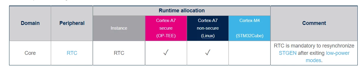

Hello ,
I see from the stm32mpu wiki RTC is not available for CM4. I am porting one RTC project from F411 to CM4 .
Is there any alternate to this which i can use having same functionality?
Br,
D

RTC and associated event (interrupts, alarms, etc..) belongs to Linux, but you could read time and date from Cortex-M4 using HAL functions and adding "stm32mp1xx_hal_rtc.c" in your project.
e.g. something like this might work:
#include "stm32mp1xx_hal_rtc.h"
RTC_HandleTypeDef hrtc;
RTC_TimeTypeDef sTime;
RTC_DateTypeDef sDate;
 hrtc.Instance = RTC;
 /* RTC clock enable */
 __HAL_RCC_RTCAPB_CLK_ENABLE();
 HAL_RTC_GetTime(&hrtc, &sTime ,RTC_FORMAT_BIN);
 HAL_RTC_GetDate(&hrtc, &sDate ,RTC_FORMAT_BIN);
Note that RTC might become not accessible when Linux is in low power.
Depending on your usage, you might need some additional computation to adjust to Linux timezone as RTC is usually in UTC. See also https://wiki.st.com/stm32mpu/wiki/How_to_use_the_RTC for Linux information.
