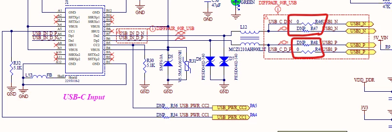

We built a customised board based on the stm32mp175c-dk2, with some changes, one of which was the addition of two USB type-c connectors.
When I try to use the USB in DFU mode, everything works fine, as long as the boot switch is turned off. When I turn the switch on, my computer does not "see" the USB at all. The same image is used on both the stm32mp175c-dk2 and our board. My computer sees the USB in stm32mp175c-dk2, but our board does not.
Anyone who can help me with this problem, as I am unable to establish an ssh connection using ethernet-over-usb?

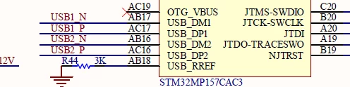

I want to usb USB_DM/P 20693W00000VOppRQAT.png
in our connector I have change the DNP resistors to use USB 2 instead of USB 1

When you talk about 'boot switch on', I assume it is boot from SD-Card.
Could you please share the UART4 console log (assuming you use that one) ?
If SD-Card boot fail (PA13 toggling), then it is needed to dump BootROM traces (https://wiki.st.com/stm32mpu/wiki/STM32_MPU_ROM_trace_analyzer#On_STM32MP15x_lines)
please confirm you are using an oscillator for HSE (as on DK2 board). If you uses a crystal, then you need to change the device tree as only BootROM will autodetect the oscillator Vs Crystal (uBoot rely on DT).
