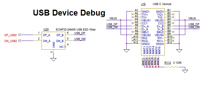

0693W00000Lvct2QAB.pngI don't think I mentioned that we are only using this Type C port as device role. I notice other designs use a USB1600 chip to support dual role for Type C. I don't understand why the driver wouldn't be able to know that the cable gets unplugged, just by the removal of Vbus from the host or something.
-Bill

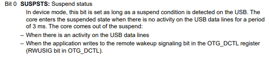

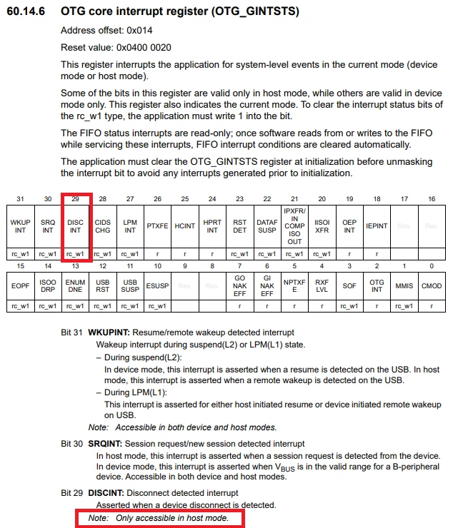

You are right, the USB DISC_INT is not available in device mode as explained in the refman.
But since you are able to detect the suspend operation and call the modified part of code that you made, it is because there is an interrupt.
in "drivers/usb/dwc2/core_intr.c"
The function that you changed "dwc2_handle_usb_suspend_intr" is called on an interrupt
#define GINTSTS_USBSUSP			BIT(11)
This interrupt is described in the refman v5.0 page 3168: https://www.st.com/resource/en/reference_manual/DM00327659-.pdf
And then you can see in the function "dwc2_handle_usb_suspend_intr" that you called your code when the status register "DSTS" has its bit DSTS_SUSPSTS to 1.
This register is described page 3208 of the refman v5.0:
So like the usb driver, you can watch this interrupt and verify the status of the register "DSTS" to know if you need to stop and start your usbotg shell script.
