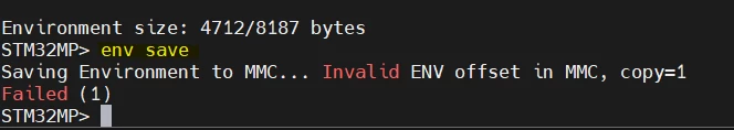

I use default uboot in openSTLinux. I use the command below to save uboot environment.
$ env save
 but it showed an error, and the environement did not save. please see the picture below.
How to fix it?

To Fix it modify uboot configuration. Below is an example:
CONFIG_ENV_OFFSET=0x884400
CONFIG_ENV_SIZE=0x4000
CONFIG_ENV_OFFSET_REDUND=0x8C4200
CONFIG_ENV_SIZE_REDUND=0x4000
CONFIG_SYS_MMC_ENV_DEV=0
For the Environment offset, please prefer to Flash layout to find the corect value.
