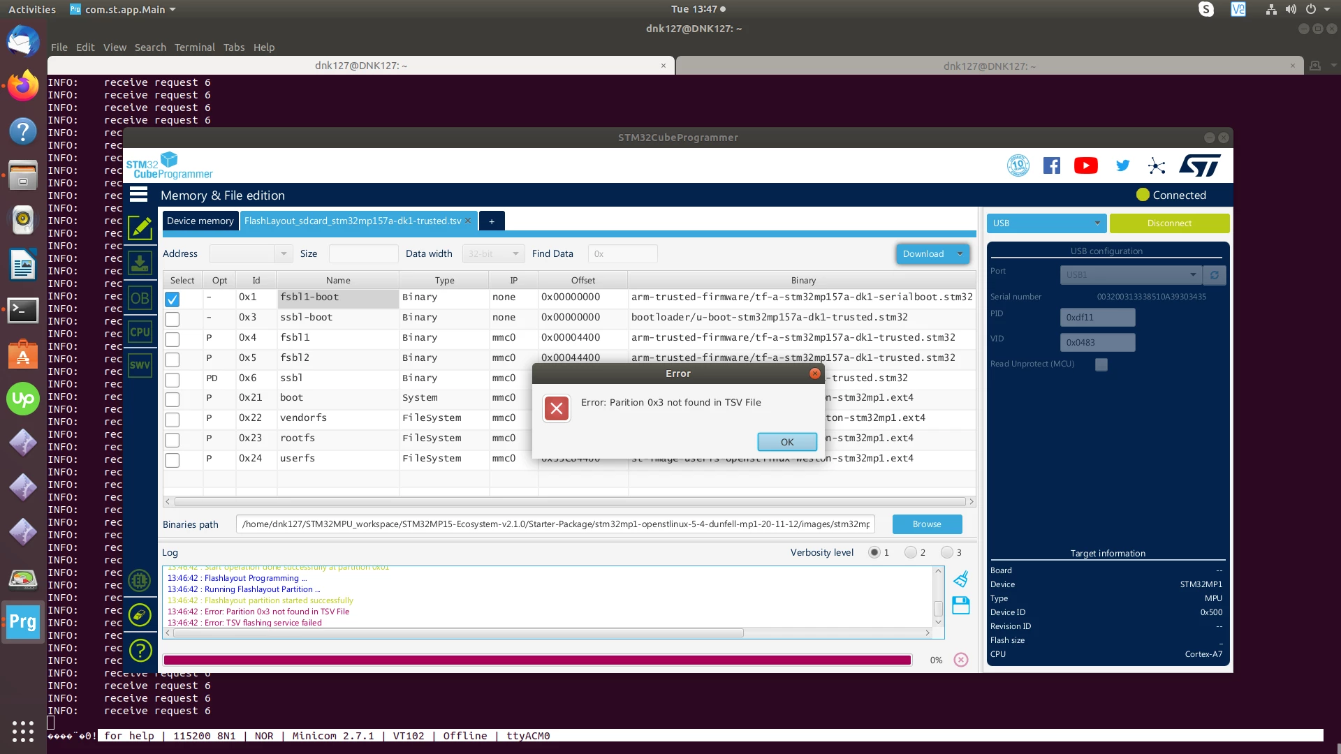

To get the very initial UART logs from the TF-A, i have just flashed the SD card with the default TF-A provided with the starter packages using Cube programmer
I've just added the stm32mp157a-dk1-trusted.tsv file and gave the path of the binary file for the same
On IDE GUI , I've just check mark for the ID (0x01) i.e fsbl1-boot
both boot pin of the board at boot-loader mode
And then, successfully downloaded the tf-a with SDcard
Now, my problem is i'm unable to get the very initial UART logs on stlink USB of the dk1 board!
(I guess, Cube programmer unable to flash the SDcard properly, because of the missing partition 0x03 ! )
Here, I've attached the screenshot of the IDE

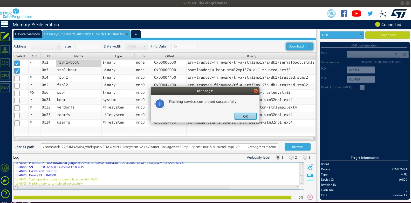

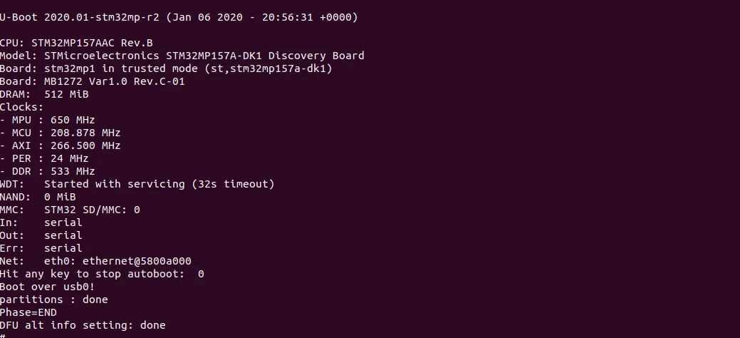

Then after, I have also added check mark for the partition 0x03 (ssbl-boot)
And, Finally i got the bootloags for the first time only (In boot mode when the boot2 & boot0 pin at the boot mode!!!)
Where, as in normal operating mode (by keeping boot0 &boot2 pin down size), I'm getting nothing!

Partitions #0x1 and #0x3 are loaded in RAM (not flashed) and are used to Flash the remaining partitions.
I think you should also read https://wiki.st.com/stm32mpu/wiki/Getting_started/STM32MP1_boards/STM32MP157x-DK2/Let's_start/Populate_the_target_and_boot_the_image#Populate_the_SDCard
