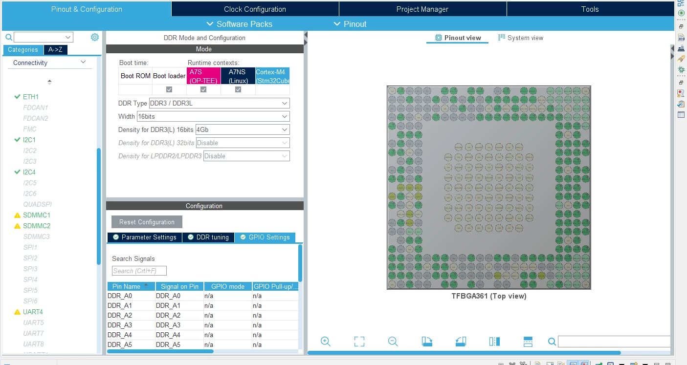

Unable to Configure DDR3 for Cortex-M4 using CubeMX. If DDR3 is dedicated for Cortex-A7 only , how Cortex-M4 is running

Hi Maksh.1 (Community Member)
Indeed, DDR is dedicated to Cortex-A7. Cortex-M4 can run out of SystemRAM or external storage via QSPI/FMC

Maksh.1
Maksh.1Author
August 4, 2021
Thanks @OlivierK​
It means by default Cortex-M4 runs on SystemRAM unless we configure FMC to Cortex-M4
OlivierK
August 4, 2021
That's correct, the Cortex-M4 runs by default on MCU-RAM (not SystemRAM as previously mentioned) unless FMC or an external memory interface is configured.
