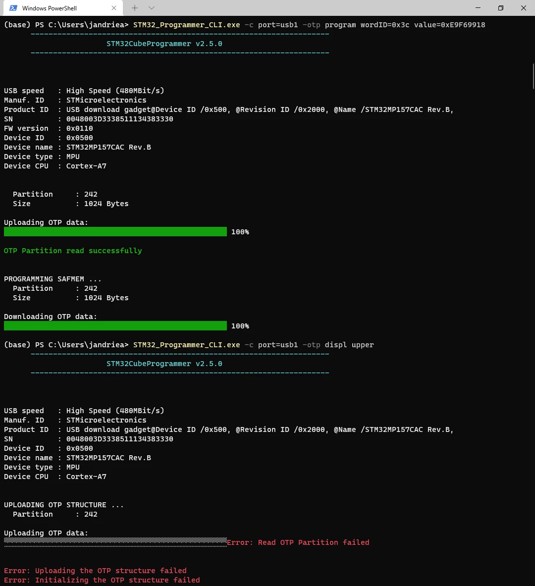

at first, I successfully flashed the image and write the OTP to word 60. However, I cannot read the OTP table after I write my configuration to the OTP

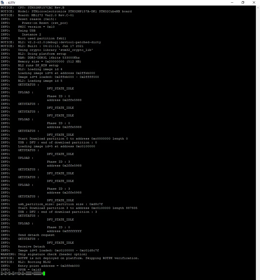

0693W00000BcFTIQA3.pngafter I got the error, I thought that I only need to reboot the board. But unfortunately, the board failed to boot. I tried to re-flash the image but the I got a timeout error. The serial out showed something like this.
0693W00000BcFSZQA3.pngAfter I tried with multiple boards, I found out that I can only write the lower 16-bit of the OTP word (ex, 0x0000FFFF). However, if I change any single bit in the upper 16-bit of the OTP word, the board will break.
I believe there is something wrong with OTP mapping that makes the image failed to boot from MMC or USB/Serial. Now, I need help to resolve this issue because I have 3 broken DK boards

Unfortunately, the boards are unable to boot up to uboot. The boot sequence stopped after printing these messages
NOTICE: BL2: Booting BL32
INFO:   Entry point address = 0x2ffeb000
INFO:   SPSR = 0x1d3
