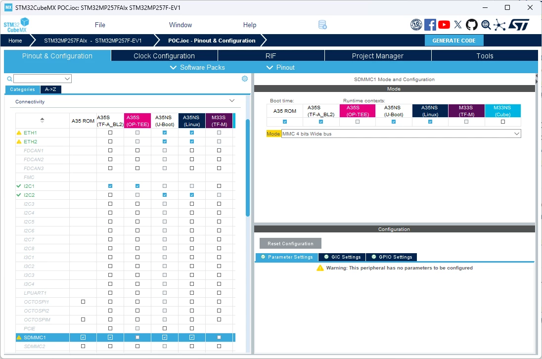

U-Boot doesn't detect eMMC on SDMMC1
I have a custom board based on STM32MP257F-EV1 but with an eMMC (4 bits) connected on SDMM1.
I have modify CubeMX configuration accordingly:
I have also modify the device tree to declare the eMMC on SDMMC1:
&sdmmc1 {
	pinctrl-names = "default", "opendrain", "sleep";
	pinctrl-0 = <&sdmmc1_pins_mx>;
	pinctrl-1 = <&sdmmc1_opendrain_pins_mx>;
	pinctrl-2 = <&sdmmc1_sleep_pins_mx>;
	status = "okay";
	/* USER CODE BEGIN sdmmc1 */
	non-removable;
	no-sd;
	no-sdio;
	st,neg-edge;
	bus-width = <4>;
	vmmc-supply = <&scmi_vdd_emmc>;
	vqmmc-supply = <&scmi_vddio2>;
	mmc-ddr-1_8v;
	mmc-hs200-1_8v;
	/* USER CODE END sdmmc1 */
After booting the board using the USB interface, U-Boot doesn't find the eMMC.
mmc rescan: gives nothing
mmc list: no answer
And to further error.
Any clues on what's happening here ?
