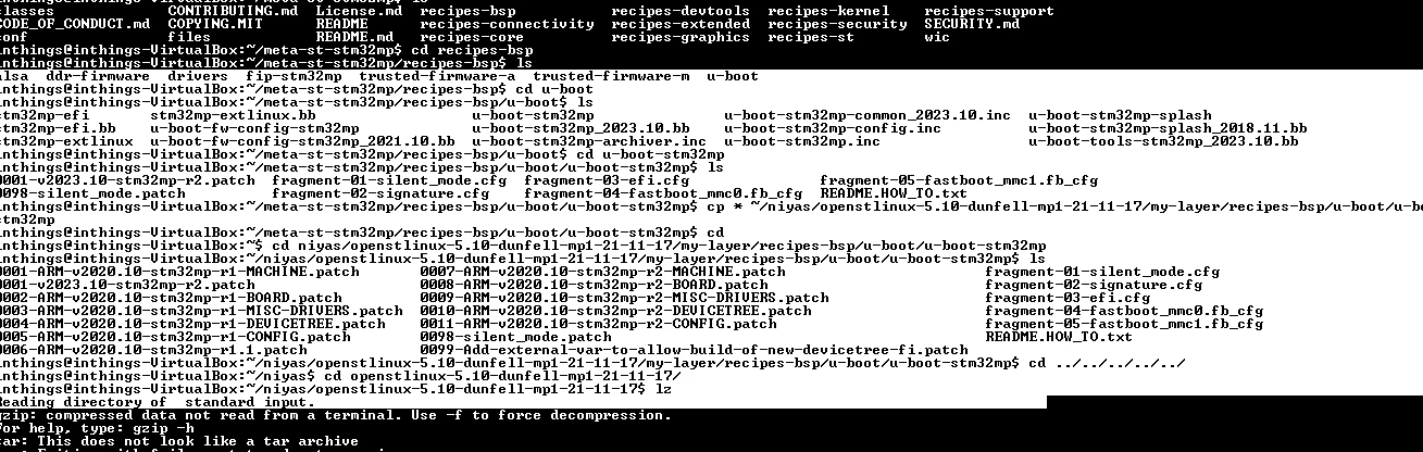

Thank you for the detailed explanation regarding the use of defconfig fragments and do_generate_defconfig. I followed the recommended approach and would like to share my current status along with the build logs and directory structure.
What I have done
I created the fragment file and bbappend structure as per the upstream ST recipe layout.
Layer structure:
i added fragment-06-spi.cfg here:
CONFIG_SPI=y
CONFIG_DM_SPI=y
CONFIG_SPI_FLASH=y
CONFIG_SPI_FLASH_STMICRO=y
CONFIG_SPI_FLASH_MTD=y
bbappend:
FILESEXTRAPATHS_prepend := "${THISDIR}/files:"
SRC_URI += "file://stm32mp15_trusted_defconfig_fragments/fragment-06-spi.cfg"
As expected, do_generate_defconfig picked up the fragment and merged it into the generated defconfig.
