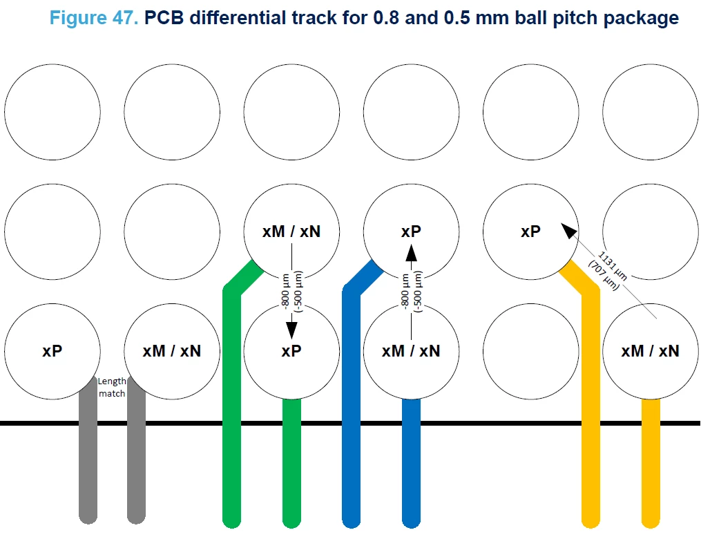

The information within AN5489 regarding the pin-lengths for the high-speed serial interfaces of the MP2 (ie,. DSI / CSI / LVDS / and "COMBOPHY") potentially has some errors, or at the very least is unclear and I would greatly appreciate some help making sense of it.

To that end - I struggle to make sense of the information regarding the trace length matching for high-speed interfaces (via AN5489), for the reasons stated below:
  • Per Section 8.19: (pg. 78; Rev3)
  • "Each package has been optimized to provide easier length matching when differential balls pair signals are not
  • directly on adjacent balls. Example: package with 0.8 mm ball pitch, when differential pairs are on two different
  • rows, the package already have around 800 μm length internal difference to allow the PCB track to match total
  • length with minimum or even no additional routing complexity. Following table shows (for example, xN minus xP)
  • length difference (inside package) at ball level to be taken into account by the PCB tool."
  • Per Figure 47 one sees that: (pg 78; Rev3)
    • The Grey Diff. Traces come from pads at the same row, therefore the PCB routed traces will already be equal and no additional tuning is required.
      • Conclusion - GOOD, this agrees with the statements in Section 8.19.
    • The Green Diff. Traces have the "xN" pad on the inside row and the "xP" pad on the outside row.  Thus, as the arrow indicates (and Section 8.19 states) "xN minus xP" = -800um (ie, pin length on the outside pad is longer than that of the inside pad, mitigating the length tuning needed on the PCB).
    • The Orange Diff. Traces have the "xP" pad on the inside row and the "xN" pad on the outside row.  Thus, as the arrow indicates (and Section 8.19 states) "xN minus xP" = 1131um (ie, pin length on the outside pad is longer than that of the inside pad, mitigating the length tuning needed on the PCB).
    • The Blue Diff. Traces have the "xP" pad on the inside row and the "xN" pad on the outside row.  Thus, based on the arrow (and Section 8.19 statements) "xN minus xP" should equal 800um (ie, pin length on xN is greater than that on xP, to mitigate length tuning on the PCB), but Fig. 47 shows this difference as being (-)800um.
      • Conclusion - This is the exact opposite of the statements in Section 8.19, this exacerbates the length tuning required on the PCB.
        • I'm guessing that the (-) sign is an error, and that the value should be (+) 800um (ie,. xN has a longer pin length than xP). Yes - ?
        • OR - Should the arrow be pointing the other direction (xP minus xN); and really it's the shorter pin length that's always subtracted from the longer pin-length?  If this is true, then the orange diff traces appear to be in the reverse order too, but somehow still got the correct pin-length of xN minus xP.
    • Reference image of Figure 47:
If the (-) sign on the Blue Diff. Traces is simply a typo, and the logic is simply "xN minus xP = difference length", then everything above makes sense.  However, if we do so, and then apply said logic to the very next item in the app note "Table 25. Package length matching values", we find the following errors/discrepancies with the statements in Section 8.19 (Each package has been optimized to provide easier length matching when differential balls pair signals are not directly on adjacent balls).

Given how many conflicts there are within Table 25, I have to assume that the length deltas are not simply "xN minus xP".  That said, if the length delta was instead a measure in favor of the expected PCB trace length matching, I don't understand why there are both positive and negative values.(?)
Seeing that the routing guidelines for many of these signals is to maintain +/- 5mils, wrongly interpreting the above information will quickly put the routing out of tolerance and potentially nonfunctional.
Apologies for my ignorance here but any assistance or clarification as to how to correctly implement trace length matching for these interfaces would be greatly appreciated.  :)
Thank you for you time and efforts and have a great day.

HI @JHardestEE
You question make sense and we already got similar from other customers.
I agree the description is somewhat fuzzy or confusing.
The AN5489 is already planned to be updated in an upcoming release.
The paragraph:
"Each package has been optimized to provide easier length matching when differential balls pair signals are not directly on adjacent balls. Example: package with 0.8 mm ball pitch, when differential pairs are on two different
rows, the package already have around 800 μm length internal difference to allow the PCB track to match total length with minimum or even no additional routing complexity. Following table shows (for example, xN minus xP) length difference (inside package) at ball level to be taken into account by the PCB tool."
will be simplify into:
"When possible, each package has been optimized to provide easier length matching when differential balls pair signals are not directly on adjacent balls. Following table shows internal package track length difference xP minus xN/xM at ball level to be taken into account by the PCB tool."
Note the correction of "xN minus xP" in "xP minus xN/xM"
Drawing will be corrected accordingly (sign will changes for the green and the yellow ones).
example, a negative value mean the internal track length of P is longer than internal track length of N (e.g. ideal value for the blue).This mean the PCB track length of P will be shorter than the PCB track length of N.
On some packages, the package inner length was not ideal due to other constrains (so might need more length compensation on PCB), this is why you could see some values not according to drawing (in length and in sign).
Anyway, for differential routing, we have seen that is is more important to route a pair in a good differential way than focus on very strong alignment of length (+/-5 mils is quite challenging).
Furthermore, DSI data were missing for D2 and D3, here are the values:
As a working reference, you could also look at STM32MP257F-DK or STM32MP257F-EV1 design files.
