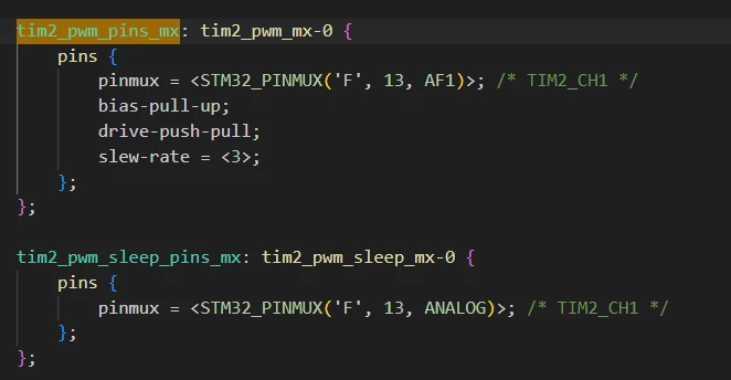

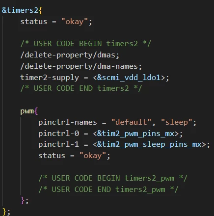

hello,st friends.
   My board use TIM2_CH1 pwm to drive a led.
dts configure as:

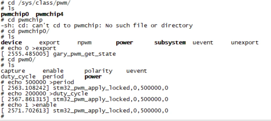

but the led can not light on.use these command
byw: I use gpio test led hardware is ok

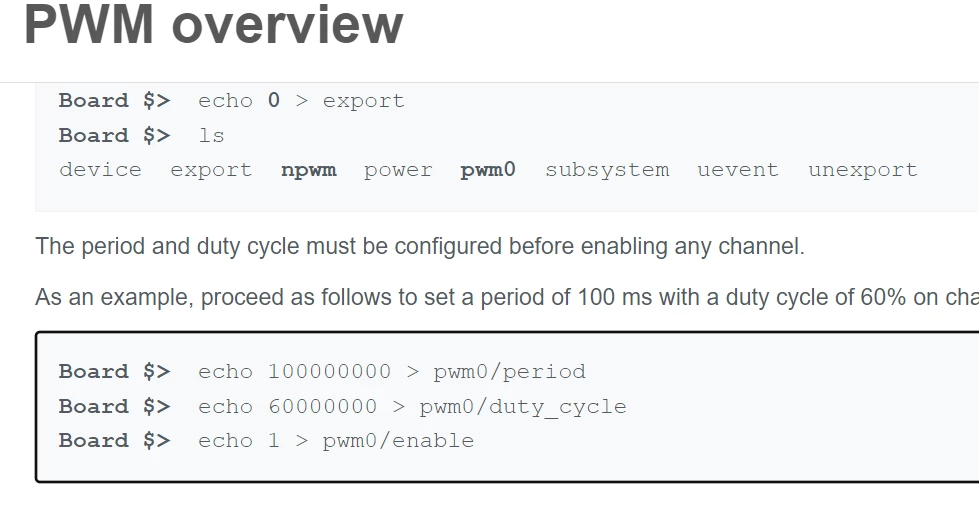

Verify that the PWM is exported correctly, you should see pwm0 listed using
ls /sys/class/pwm/pwmchip0

hi @Sarra.S
I use oscilloscope vefify no pwm out on PF13;
but
1、if change pwm channel1 to PA5.that is ok
2、Enable all 4 pwm out,all other 3 pwm output correctlly excpt for PF13

I verify TIM2_CH1 bare metal using PF13.  it is the same result as linux not working.
So  I assume that PF13 can not be assigened to TIM2_CH1.
please help to double check this. thank you
