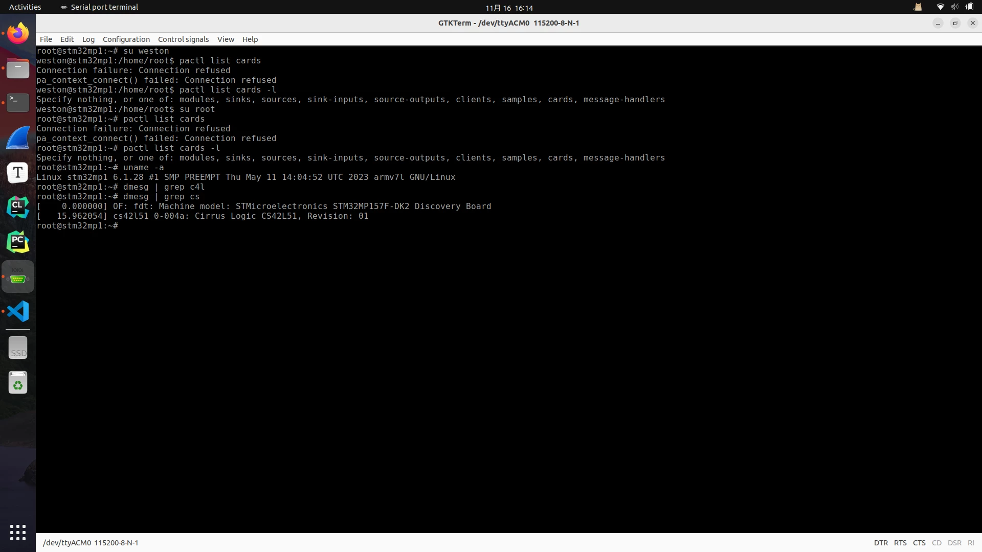

Nov 16, 2023 08:22 UTC
Hello
pactl list cards return none:
But from the log I'm sure the cs42l01 has been probed:
root@stm32mp1:~# dmesg | grep cs
[ 0.000000] OF: fdt: Machine model: STMicroelectronics STM32MP157F-DK2 Discovery Board
[ 15.962054] cs42l51 0-004a: Cirrus Logic CS42L51, Revision: 01
root@stm32mp1:~# cat /proc/asound/cards
--- no soundcards ---
root@stm32mp1:~#
It seems the hdmi-stereo output is not actived,right?
I read this:https://wiki.st.com/stm32mpu/wiki/Soundcard_configuration#Cirrus_cs42l51_output_configuration
but still no solutions.
Any other advise?
Regards,
Thank you.
