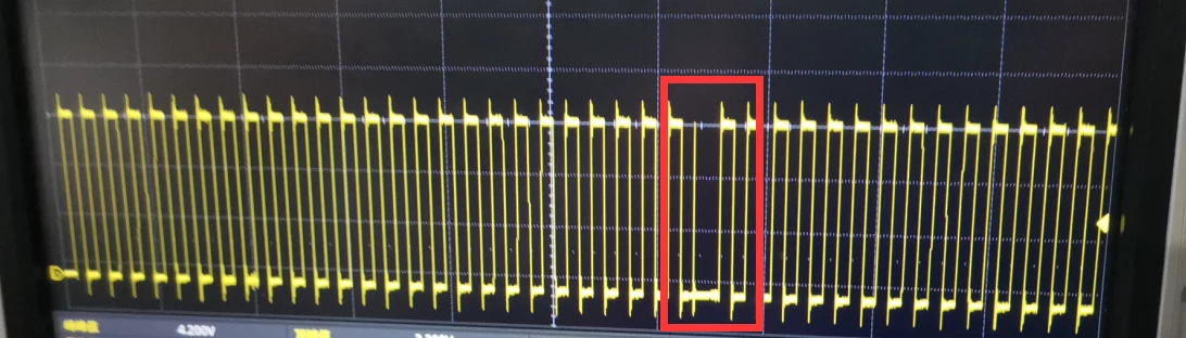

4)Test waveform of mass production mode:
0693W000008yagZQAQ.png​

In addition, when you keep pressing the oscilloscope "SINGLE" button, the waveform interruption will be collected
PatrickF
April 2, 2021
Did you have a fixed or a random recurrence of the 'missing PWM pulse' ?
Is the 'missing PWM pulse' always similar or have various location in the waveform ?
Could you zoom around the 'missing pulse' and check if the time between pulses is stretched (which might be linked to an unwanted short clock gating) or not (which might be linked to a timer signal output masked for a short period).

Hi:
Thank you for your reply. This "missing PWM pulse" in the mass production mode is not random. It is the "missing PWM pulse" every time you press the "single" button of the oscilloscope. This is not the case when debugging with IDE alone.The missing part only occurs in a single PWM cycle (1.25us)
