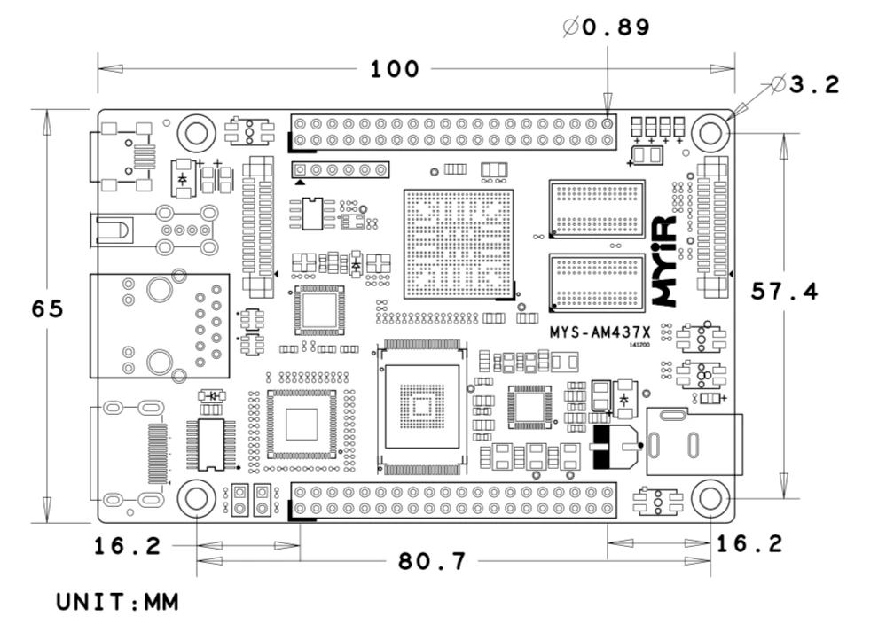

Hi Olivier, thanks for the quick reply :)
The STEP file looks a bit like overkill, to be honest - but I'll try and find a viewer for the format on my Mac, and see if I can get the info I need. What I really wanted (I mention this in case it's there and I missed it) was something like:
Cheers :)
