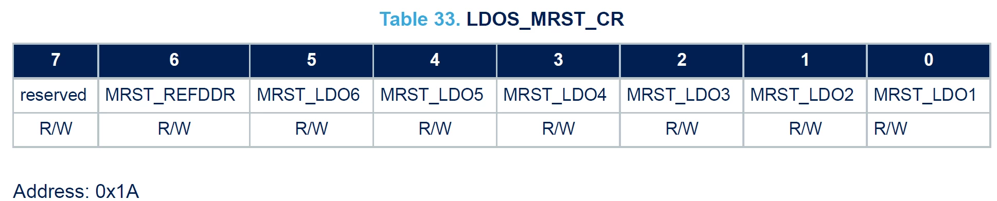

roland van straten
Aug 11, 2024 7:04 AM UTC
Thanks for the note:
I measured the -DK2 and the behavior of BUCK3, LDO2 etc and indeed the STPMIC1A is 3.3V and stable and always on. The LDO e.a. are affected when reset occurs.
Tnx
Vincenzo
Aug 12, 2024 4:23 AM UTC
Hi roland van straten,
you need to program the below address, see STPMIC1 DS rev.10 @page83
set bit to 1 active mask reset option for selected LDO for next
reset power-cycle. It is a single shot option and then register is reset to default
Regards
