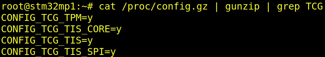

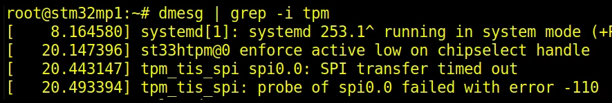

I would like to integrate the STPM4RasPI with MP135F-dk. After following the https://wiki.st.com/stm32mpu/wiki/STPM4RasPI_expansion_board tutorial, I am receiving an error.
Driver is enabled:
STPM4RasPI module is properly attached.
Do you have any possible solutions?

Hi @Olivier GALLIEN ,
Instruction given in https://wiki.st.com/stm32mpu/wiki/X-LINUX-TPM_expansion_package was helpful. I had to adjust arch/arm/boot/dts/stm32mp135f-dk.dts as:
&spi5{
	pinctrl-names = "default", "sleep";
	pinctrl-0 = <&spi5_pins_a>;
	pinctrl-1 = <&spi5_sleep_pins_a>;
	cs-gpios = <&gpioh 11 0>;
	status = "okay";
	st33htpm0: st33htpm@0{
		status="okay";
		compatible = "st,st33htpm-spi";
		#address-cells = <1>;
		#size-cells = <0>;
		reg = <0>; /* CS #0 */
		spi-max-frequency = <10000000>;
And then the module was successfully detected.

Hi @jschneider
Please confirm you are on top of release V5.
For this last release you may also try https://wiki.st.com/stm32mpu/wiki/X-LINUX-TPM_expansion_package which have been validated on DK 135F.
Cross-checking both article and solution may help to find the missing piece
