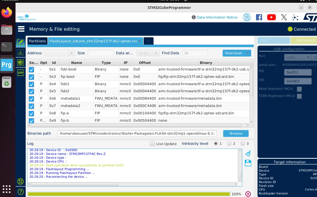

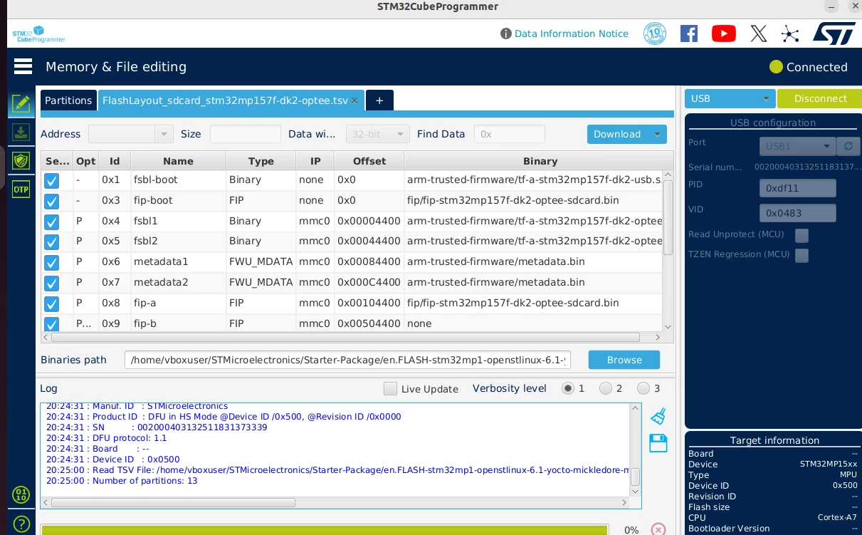

STM32MPU157F-DK2 flash process fails after partition 3 reconnects
I'm trying to build a linux image for this target. I had successfully(after a lot of trial & error) flashed the target with the Starter package.
For some strange reasons when doing the distribution package, I had to reinstall my VM and now I'm trying again this process. This is the data before downloading
The problem is that the download process fails at this stage:
It happens the same with the distribution package with an image I already built I can confirm the "usb gadget" is forwarded to the VM.

It seems you can't reflash the starter package, which is what I was trying to do...

Hi @JPabl.1
please confirm you use a STM32MP157F-DK2 board with ST Starter Package (and not another board or custom board).
If not related to VM USB link (which is the most frequent cause of 'reconnect' issue), could you share the UART console output (available thru STLink VCP) to see if any errors.
Regards.
