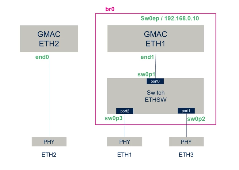

I have the STM32MP257x-EV1 up and running the base image. I have included the layers for the Ethernet switch and TSN. I am trying to understand the embedded Ethernet Switch better. I am working with the assumption that I can plug in two endpoints to ETH1 and ETH3 with no interaction from the MPU and pass ethernet traffic (e.g., ping).
But this does not work from the get-go. Is there something that needs to be done to enable it?

Hello, Here is the network config after you applied the linux expansion for tsnswch. There is no application so you have to do it manually. For ex, if you assign IP 192.168.0.20 on the PC plugged on ETH1, you will be able to ping sw0ep or ping another PC plugged on ETH3 with a static IP set to 192.168.0.30. If Then you want to test ETH2, you can assign end0 a static new network IP address and activate IPforwarding on the board.

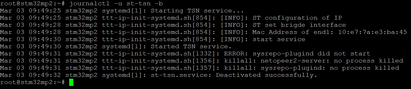

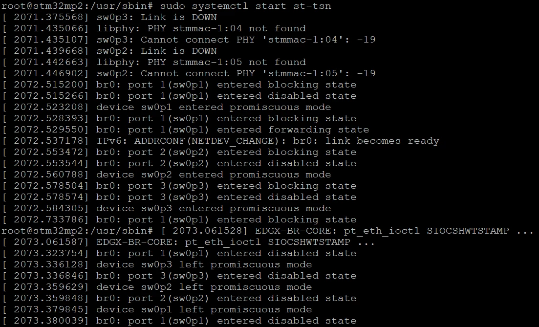

It seems your default network configuration is wrong, so need to check why ....
As described in wiki the network config is set thanks to this script = /usr/sbin/ttt-ip-init-systemd.sh
So try to apply manually the config and check what is failling.
user_ABCD
user_ABCDAuthor
Sep 18, 2024 15:41 UTC
This service will not start, nor does running the script manually work.

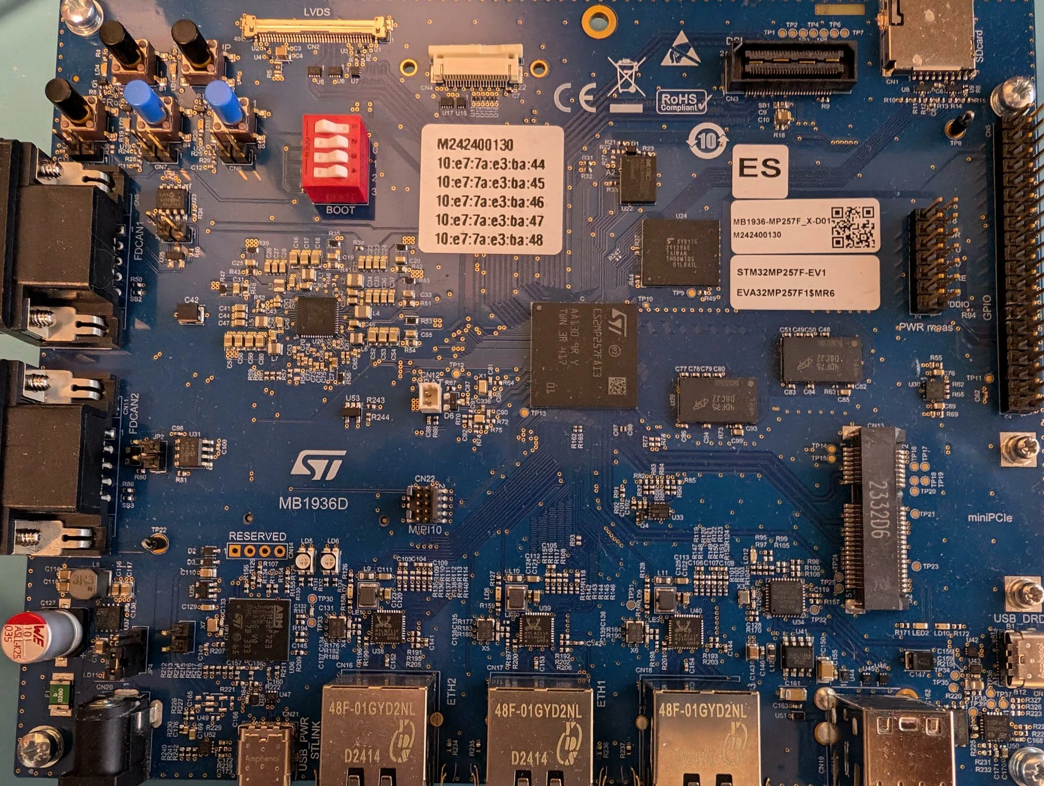

Could you please share a photo of your board (taken from above)
user_ABCD
user_ABCDAuthor
Sep 19, 2024 10:19 UTC

In term of HW all seems ok.
