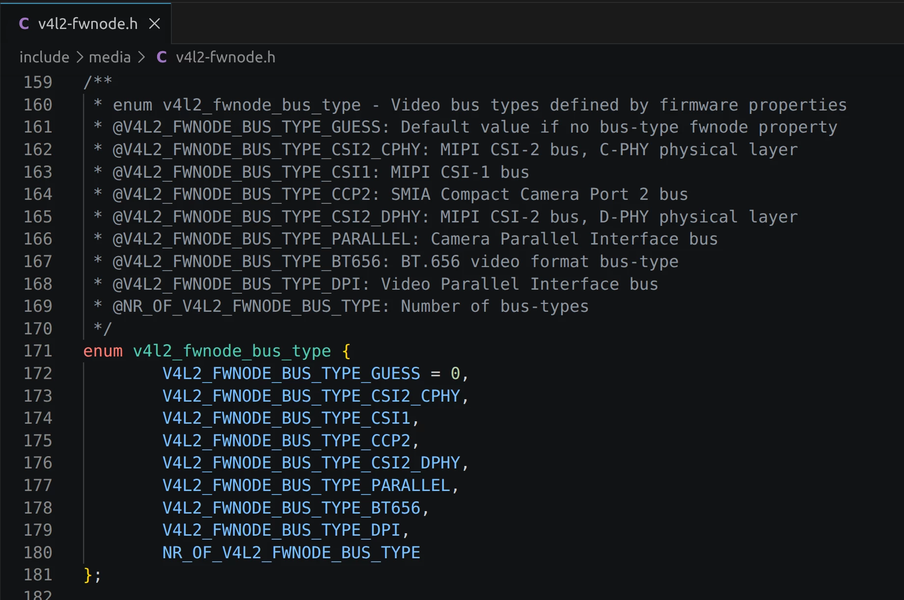

  • In the device tree “bus-type = <6>;” mean parallel interface with embeded sync code, Is it right?
  • In the device tree “bus-type = <5>;” mean parallel interface with PIXCLK. VSYNC. HSYNC, Is it right?

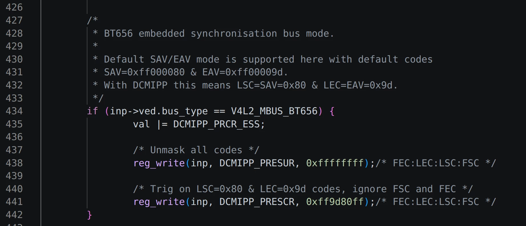

  • How to modify embed sync code? device tree or ST driver code.

Concerning the bus-type, the value corresponds to the following enumeration:
So your 2 first points are right.
  • If the PIXCLK is accepted by STM32MP257 for interface with embeded sync code and the /proc/interrupts should get something. Is it right?
The DCMIPP interrupts will be increased as soon as the DCMIPP is able to capture and catch frames. If nothing move on it, it means that somewhere the DCMIPP was not able to grab camera frames to process it.
I guess you are looking for the code present in the Linux kernel driver: drivers/media/platform/st/stm32/stm32-dcmipp/dcmipp-input.c
