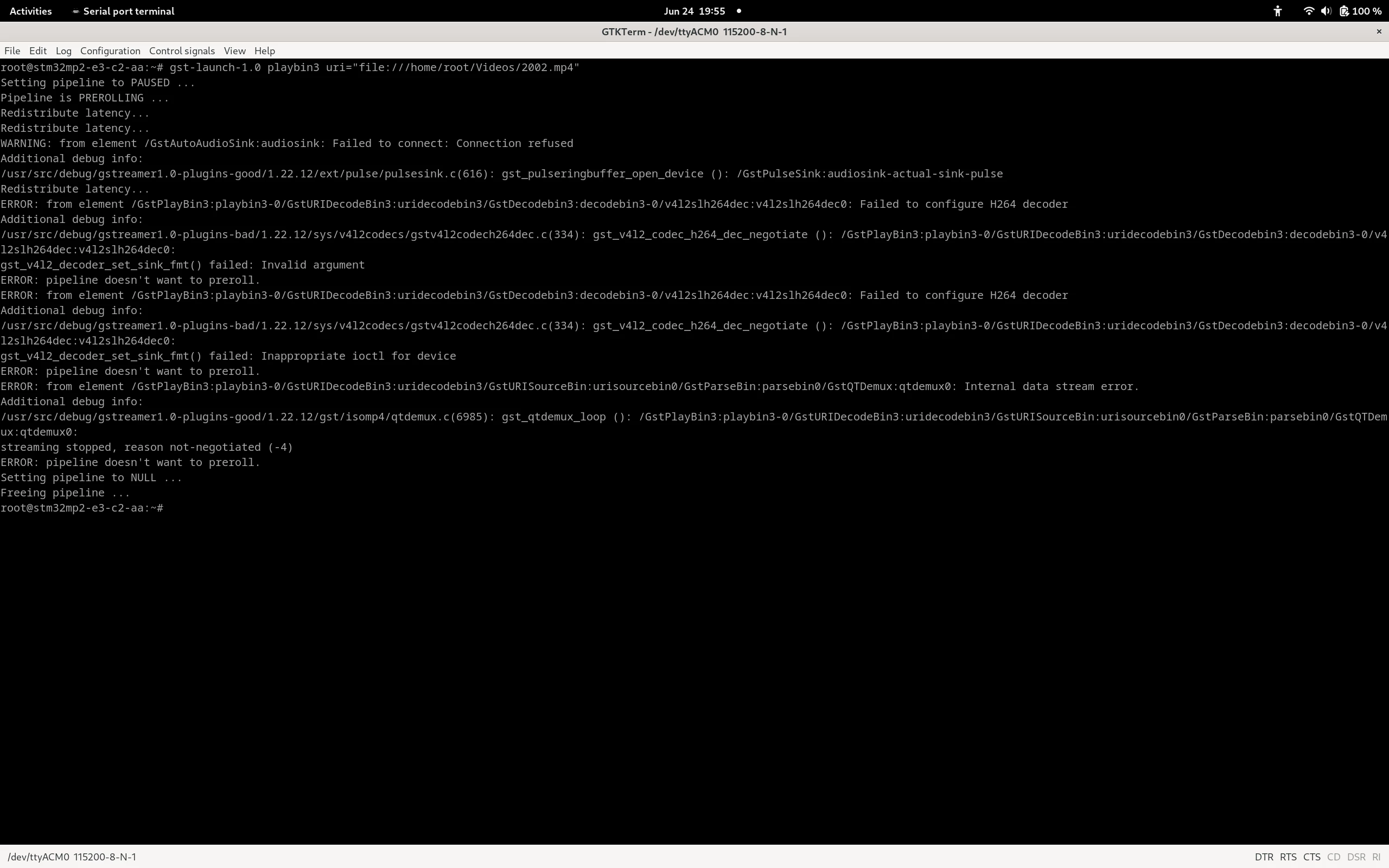

Now I have a problem. The gstreamer cannot work properly when playing mp4 format video.
Does the h264 decoder need to be activated or enabled?
I run this command
gst-launch-1.0 playbin3 uri="file:///home/root/Videos/2002.mp4"
here is the error:
and also the gst-discovery-1.0
root@stm32mp2-e3-c2-aa:~# gst-discoverer-1.0 Videos/2002.mp4
Analyzing file:///home/root/Videos/2002.mp4
Done discovering file:///home/root/Videos/2002.mp4
An error was encountered while discovering the file
 Failed to configure H264 decoder

Jul 11, 2025 6:50 AM UTC
I got the information that today the driver of the HW video decoder inside MP25 manages video with a maximum height of 1088.
If any update occurs on the subject, I will let you know.
BR,

Jun 30, 2025 11:48 AM UTC
to get the H264 hw accelerated decode on MP257, you need to use the following command:
"gst-launch-1.0 filesrc location=<your .mp4 file> ! qtdemux !
h264parse ! queue ! v4l2slh264dec ! autovideosink"
BR,
Philippe.

Jun 30, 2025 12:44 PM UTC
Hello, Philippe.
I test the command you said, but still failed.
root@stm32mp2-e3-c2-aa:~# gst-launch-1.0 filesrc location=Videos/mp4/noon.mp4 ! qtdemux ! h264parse ! queue ! v4l2slh264dec ! autovideosink
Setting pipeline to PAUSED ...
Pipeline is PREROLLING ...
Redistribute latency...
ERROR: from element /GstPipeline:pipeline0/v4l2slh264dec:v4l2slh264dec0: Failed to configure H264 decoder
Additional debug info:
/usr/src/debug/gstreamer1.0-plugins-bad/1.22.12/sys/v4l2codecs/gstv4l2codech264dec.c(334): gst_v4l2_codec_h264_dec_negotiate (): /GstPipelin:
gst_v4l2_decoder_set_sink_fmt() failed: Invalid argument
ERROR: pipeline doesn't want to preroll.
Setting pipeline to NULL ...
Freeing pipeline ...
Now I upload the video noon.mp4 so you can also test it on your side.
BR, Bruce.
