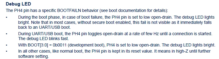

Pin PG4 (FAILBOOTN) is connected to a red LED. During normal boot, this LED starts blinking, and after flashing the TF-A (whether via USB or Serial), it turns solid.
The documentation says that the FAILBOOTN LED blinks when the board initially boots in USB/UART mode, meaning it doesn't even attempt to load the stock firmware?

notice that BOOTFAILN for MP235 platform is on PH4 pin (and not PG4 as you mention).
Usually in DFU it blink until USB is connected (and could stop either high or low, not important).
refer to AN5489

According to BOOTFAIL pin it is my mistake. The LED connected to correct PH4 pin, yes.
