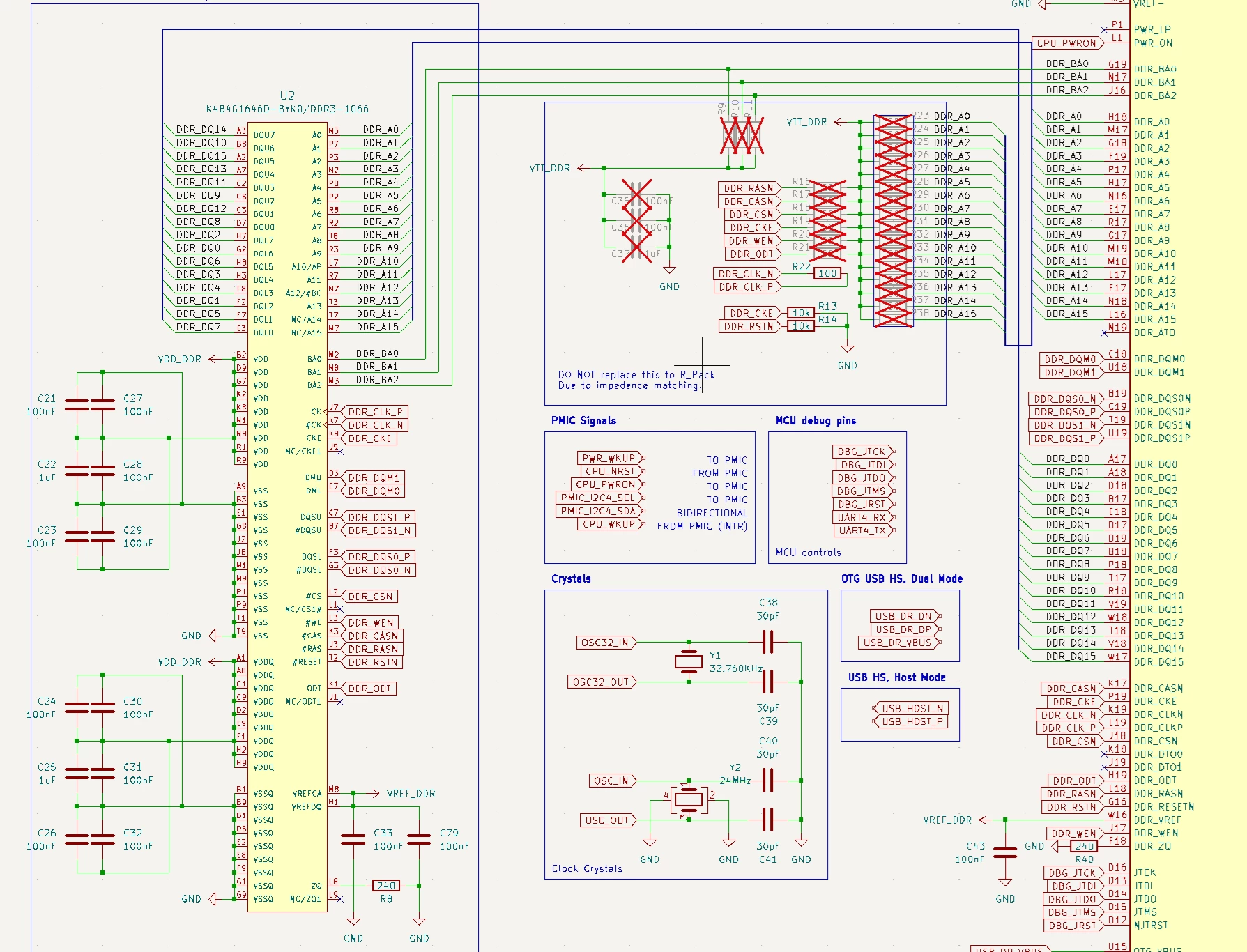

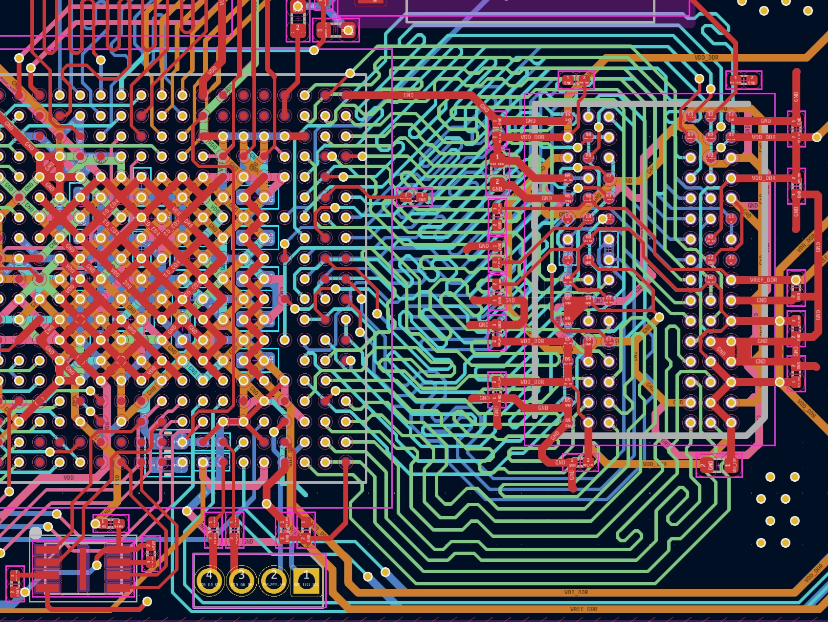

I didn't upload my project to anywhere yet. I'm second time to design these MPU board, so, no good layer-plan did. just ground planes are setup between signal layers. just I target to make my board working. then, I'll study more details, and modify my designs.
my board's target size is small so (65mm x 38mm including LTDC routings), no 3W rule could be applied, so I just adjusted to 2W. And no additional fees for via in pads at JLCPCB I used, so I just drawn like above. JLCPCB does not support micro vias including blinded via, etc, so I just placed through hole vias. (due to make it cheap as possible)
In DDR3, ST's application note says that, no termination resistors are needed for `point to point` topology, so its are marked as `no solder, no place`. and bit swaps in byte groups are allowed.

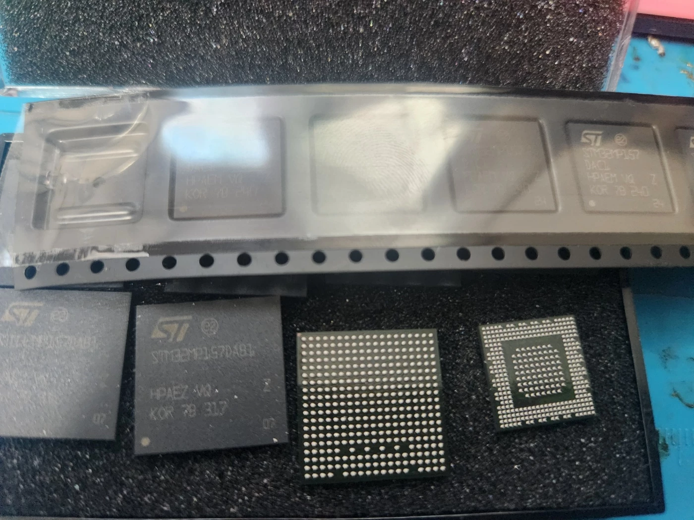

P.S. it's important to check BGA pitch availability of PCB manufacturer. for example, JLCPCB's capability couldn't cover MP157DAC1. at first, I bought MP157DAC1, it could'nt be used with JLCPCB. so I just gave up, and chnaged to MP157DAB1.

Thanks for the tip about JLCPCB. Its surprising they cannot handle 0.5mm pitch BGA, or was it because hole in via for 0.5mm ? 18pF caps seem to need 10pf int. load xtals which are hard to find. What about using a 3.3V 24 Mhz OSC instead of an XTAL ?  I plan to use an 12.5pf XTAL with 22pf caps.  Making boards with 6~8 layers (ENIG) with correct stack-up for impedance so far seems a costly affair, specially for low quantities. (5-10pcs)
May 14, 2025 2:04 PM UTC
They can not handle patterns between vias and pads, only through holes are available. they rejected by that reason: `hole in via for 0.5mm`, `all patterns for fan-outs in my artwork violates capabilities of JLCPCB`.
