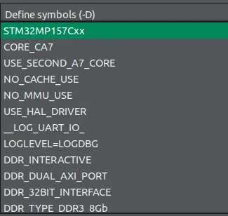

MWoło.2
MWoło.2Author
Senior III
Apr 19, 2023 18:10 UTC
Hi Patrick,
I try to compile ddr tool for M4 but printf not working for some reason.
I have my own custom board with changed UART4 debug ports and I2C4 different ports.
So I changed ports and pmic is configured well UART4 also but I see on the console only "DDR>" and I can provide some text like "step 3" but not see anything like DDR> and my texts. Of course, I assigned buttons and LEDs which seem to work
Reworking this firmware is a difficult task.
The preprocessor definition I used are
_legacyfs_online_stmicro_images_0693W00000biQwbQAE.pngHow to force to see printf
  • After the step above lines I see nothing in my uart terminal console why?
MWoło.2
MWoło.2Author
Senior III
Apr 19, 2023 20:06 UTC
After taking and reworking project STM32MP!57C-DK2-DDR_UTILITIES_A7 something starts working.
So the result is as follow
for 8Gbit/16bits data width
DDR>test 0
 test_databus KO @ 0xc0000000
Test Simple DataBus failed [2]
Test All failed [2]
DDR>
and the same for 4Gbit/16bits data width
DDR>test 0
result 1:Test Simple DataBus = Passed
result 2:Test DataBusWalking0 = Passed
result 3:Test DataBusWalking1 = Passed
result 4:Test AddressBus = Passed
result 5:Test MemDevice = Passed
result 6:Test SimultaneousSwitchingOutput = Passed
result 7:Test Noise = Passed
result 8:Test NoiseBurst = Passed
result 9:Test Random = Passed
result 10:Test FrequencySelectivePattern = Passed
result 11:Test BlockSequential = Passed
result 12:Test Checkerboard = Passed
result 13:Test BitSpread = Passed
result 14:Test BitFlip = Passed
result 15:Test WalkingZeroes = Passed
result 16:Test WalkingOnes = Passed
Result: Pass [Test All]
 Of course, I changed the preprocessor definition before compilation and testing.
I think some of the parameters for 8Gbit DDR3 are wrong because I made the test memories on the same hardware configuration (of course A15 is included).
STM32CUBEMX gives some default parameters.
