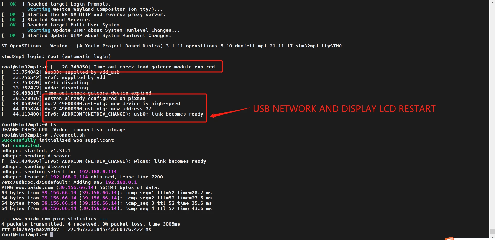

stm32mp157caa3 galcore.ko
Time out check load galcore module expired
whay are we getting this, how to fix this, ?

I make a try just now, and now it works.
It's not enough to compile the kernel, you also need to compile the module. And you must follow the steps on the wiki.
But "Time out check load galcore module expired" still exits, which results in the USB network card and screen restart. This is too bad.

[ 11.595874] stm32-crc32 58009000.crc: Initialized
[ 11.647514] galcore: disagrees about version of symbol module_layout

Hi Olivier,
attached is the current log,
I did rebuild all my custom image once again from wiki st link steps followed, the distro is openst-weston-wayland.
now i can able to see Galcore getting probed.
[  11.165705] galcore: loading out-of-tree module taints kernel.
[  11.235260] Galcore version 6.2.4.190076
how can i test STM32MP1 GPU/galcore.ko functionality ?
