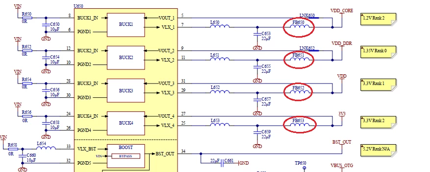

Due to electromagnetic compatibility, ferrites were installed in the VLX paths of the PMIC voltages. With the 0 ohm resistors, as also found in the EVAL design, the RAM problems are eliminated. Memtester runs without any problems.

In addition, we have encountered problems with the PMIC in the newer revisions. On some boards the PMIC only supplies 0.9V on VDDCORE at startup, but according it's registers should supply 1.2V. ALTERNATE mode should be off, still investigating here.
However, there have been no changes in hardware design on these paths, neither to the RAM nor to the PMIC.
Whether PMIC and RAM are related to each other is also unclear to us at the moment.

Reading your last message make us think that the first thing you have to investigate on is the PMIC sub-system. Observing this 0.9V on VDDCORE is not normal as you can imagine. This could be a layout issue, but also a too high voltage accidently applied to supply the PMIC (maximum without damage is 6V).
When this first part is totally understood, then it will be time to focus on DDR. VDDCORE is a pilar for the DDR sub-system, it has to be at expected value to make DDR sub-system (and its PLL) working correctly.

NicoHAuthorBest answer
Jan 9, 2026 10:11 AM UTC
Hello Nicolas,
a brief update on the solution to the problem:
Thank you very much for your ideas and help!
