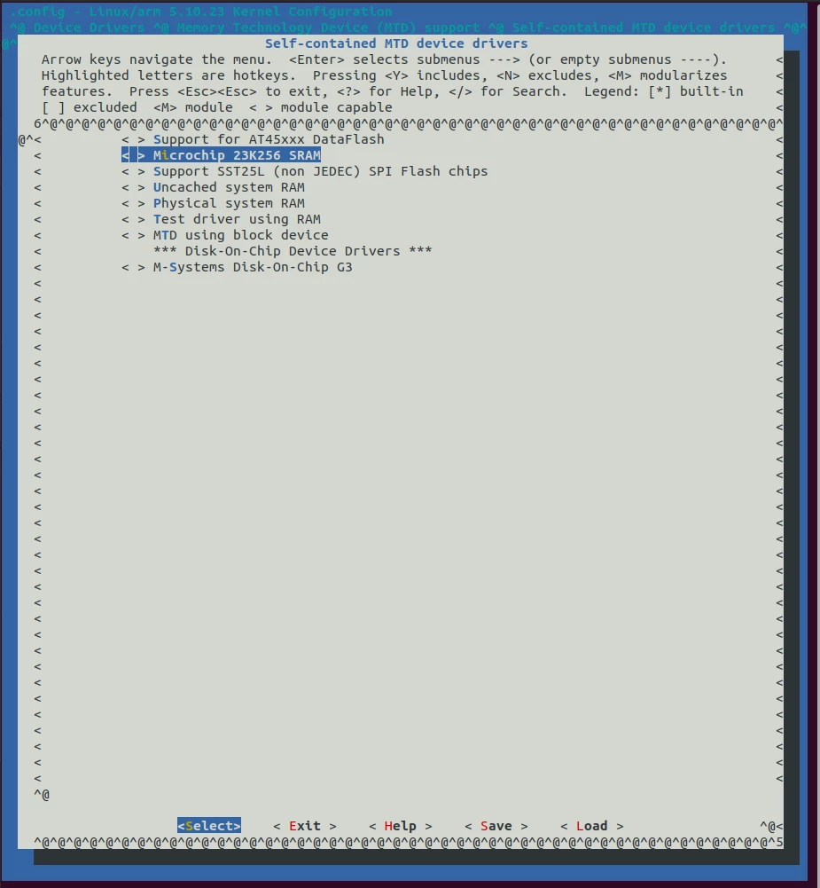

STM32MP157C qspi nand flas w25n512 using
I am using stm32mp157c and working initialize mtd nand flash w25n512. I am following the
https://wiki.st.com/stm32mpu/wiki/MTD_overview .
I don't have choise "Support most SPI Flash chips (AT26DF, M25P, W25X, ...)" in chapter 3.1.2 in my kernel menuconfig.
Did I not open a section that I should have opened or is there a different problem?
Best Regards,
Ali Mesut Ince

Hello @aliMesut​ ,
Nice catch, this choice doesn't exist anymore. We updated the wiki page, the modification must be visible.
https://wiki.st.com/stm32mpu/wiki/MTD_overview#SPI_NOR-2FNAND_Flash_memory
By default, these choices must be enabled:
[*] Device Drivers --->
 <*>Memory Technology Device (MTD) support --->
 <*>NAND --->
 <*>SPI NAND device Support
 <*>SPI-NOR device support
They enable the SPI NAND and SPI-NOR support, you don't need to enable something else in the make menuconfig.
Do you encounter an error?
Regards,
Kevin

Hi @Kevin HUBER​ ,
Thank your for your suporting. No i didn't get any errors.
