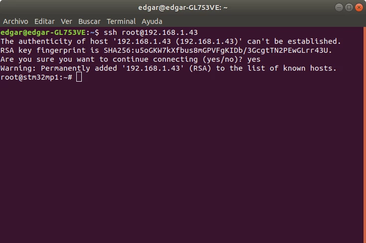

Did you enter 'root' at both User and Password on the first SSH windows ? Sound strange to have edgar@192.168.1.6, should be root@192.168.1.6
Maybe have a look also to https://wiki.st.com/stm32mpu/wiki/How_to_perform_ssh_connection

Hello, I used your link and I get:

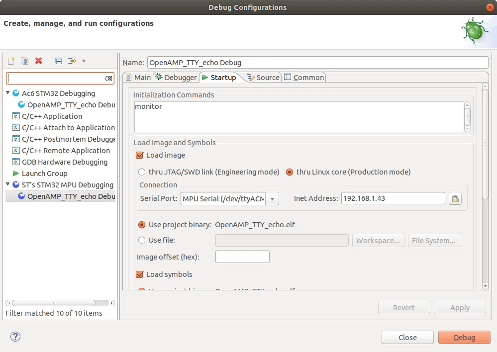

Next I in workbench my debug configuration is:0690X000009ZfjkQAC.png

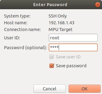

I next dialog: user and pass are: root
