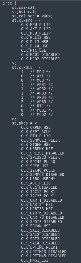

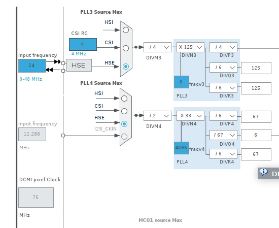

I am working stm32mp157c. I'm trying to change the clock rate of stmcubeide using pll4q for spi45 (StmCubeIde outputs are attached.). Also The bsp setting is attached .
Pll settigs is;
   st,pll@3 {
      reg = <3>;
      cfg = <1 32 5 66 5 PQR(0,1,0)>;
      frac = <0x1000>;

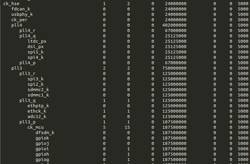

I see the clocks are set correctly except pll4q (in linux "cat /sys/kernel/debug/clk/clk_summary" command).
It turns out 25.125Mhz when it should be 6MHz (linux outputs are attached).
I measure the pll4q clock with oscilloscope. Same as the value i see in "cat /sys/kernel/debug/clk/clk_summary" (not 6MHz, it is 25.125Mhz).
Where do you think the problem might be?

sound your effective value for DIVQ is 15 (divide by 16) instead of 66 (divide by 67). 402/16 = 25.125 MHz.
Any chance there is somewhere in your DT an entry which override the 66 value by 15 ?
Please confirm the PLL4 is running at 402MHz :
	cat /sys/kernel/debug/clk/clk_summary | grep pll4 -A 20 -m 1
Then need to confirm the effective DIVQ value (need to install devmem2 using "apt-get update" then "apt-get install devmem2")
Read RCC_PLL4CFGR2, DIVQ is on bits 14-8
devmem2 0x5000089C W
if ok check other PLL settings (RCC_PLL4CR, RCC_PLL4CFGR1, RCC_PLL4FRACR
devmem2 0x50000894 W
devmem2 0x50000898 W
devmem2 0x500008A0 W
Regards.

In this case, pll4 vco becomes 480mhz (i checked cat /sys/kernel/debug/clk/clk_summary | grep pll4 -A 20 -m 1 command). pll4q should be 6 mhz but it is 24 mhz.
  1. devmem2 0x5000089C W -> read value is 0x00051305
  2. devmem2 0x50000894 W -> read value is 0x00000023
  3. devmem2 0x50000898 W -> read value is 0x01010027
  4. devmem2 0x500008A0 W -> read value is 0x00010000
But I did not understand what conclusion to draw from these data.
