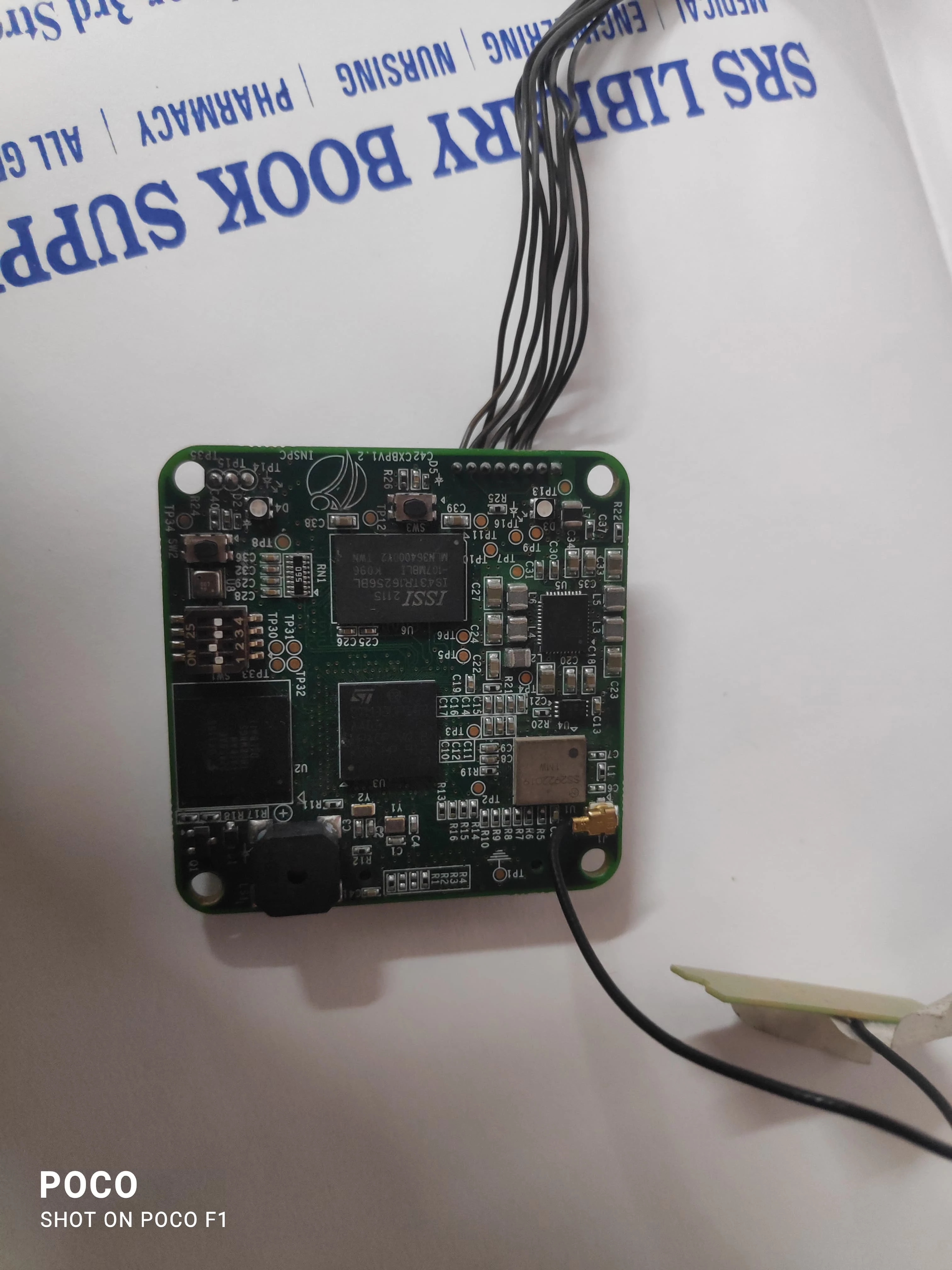

Why does the STM32MP157AAD3 have a higher heat or temperature? We have an STM32 board that has interfaces for PMIC, DDR3, temperature sensors, VOC, EMMC, LEDs, push buttons, WIFI+BLE modules, 8-pin connectors, wake-up switches are build in same board Sir, we have observed that the board can get as hot as 90 degrees Celsius when it is operating at full load. How can we deal with this heat problem? Could you please elaborate? I've included pictures of the board for your reference.

there is no magic around thermal, as the board is small and you are using the smallest STM32MP15x package, the heat dissipation is limited.
Is the 90C a concern ? What is the Tj (could go up to 125C for STM32MP157A)?
Is the PCB has enough power plane for good overall heat dissipation ?
Did you check with thermal camera what are the main contributors of heat ?
Did you built some product thermal study or simulation ?
What is your overall consumption (board 5V or ideally split power per supply ) ?

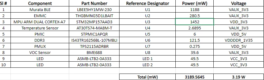

I'm puzzled with the "Overall power consumption is 3.19W and 1.33A with 5V supply Board."
1.33A on 5V is 6.65W (which seems huge). Could you split this power consumption by board subsystems ?
For reference, a STM32MP157F-DK2 running Starter Package demo is around 2W to 2.5W (with display).
If you look at AN5036, an STM32MP157-EV1 board with SoC consumption of ~1W is heating to less than 50C Tj (ambiant 25C). Board is much larger than yours.

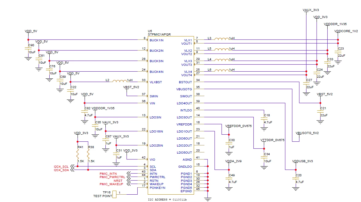

For LDO input voltage of STPMIC1, you could sometimes use another buck output (i.e. 3.3V) if LDO output voltage if lower (e.g. 1.8V). then you reduce the wasted power as you partly benefit of the Buck efficiency.
This is the case for LDO1/LDO6 on our DK2 board

First is to do study to see each component power consumption (from their datasheet or else) and check if measurements are aligned with theory.
Anyway, 96C Tj is probably normal for an heavy loaded CPU with a low heat dissipation HW (small board).

we are using this connections of STPMIC used sir., Its ok or Not for LDO connections sie?
This is our Board subsystem Consumes the power dissipation.
Sir Please clarify, To reduce the resistance value of some IC's in the board, power dissipation will be decreased or not sir? i think it will be decreased. but how to reduce the resistance value in generally? please clarify this final question sir... I'm waiting for your positive responses.

if I read well the table above, the consumption on VDD_3V3 is 440mA, which is quite huge (the absolute maximum rating in datasheet is precisely 440mA). If you really measure 440mA on your board, then there is likely some issues (IO conflict or else).
Is it measurements or just estimates from datasheets ?
You should do measurements on your board to understand where the (abnormal) power/heat is generated. This could be done by measuring current (if there is connections for that). alternatively, thermal camera could help a lot as well to focus on where most heat if generated.
By experience, 1000mW on heavy loaded STM32MP15 (mostly on VDDCORE) is possible and Tj=96C is also acceptable with small board and small package. Single DDR3L could be 250mW, DDR terminations could be 200mW. STPMIC1 efficiency is somewhat above 80%, so some hundred of mW dissipated on STPMIC1 should be expected as well. For other components, I cannot state.
Please clarify which issues you are facing (hot board is normal if really using 1.33A/5V=6.7W on a small board, but this power should not come only from MP15).
